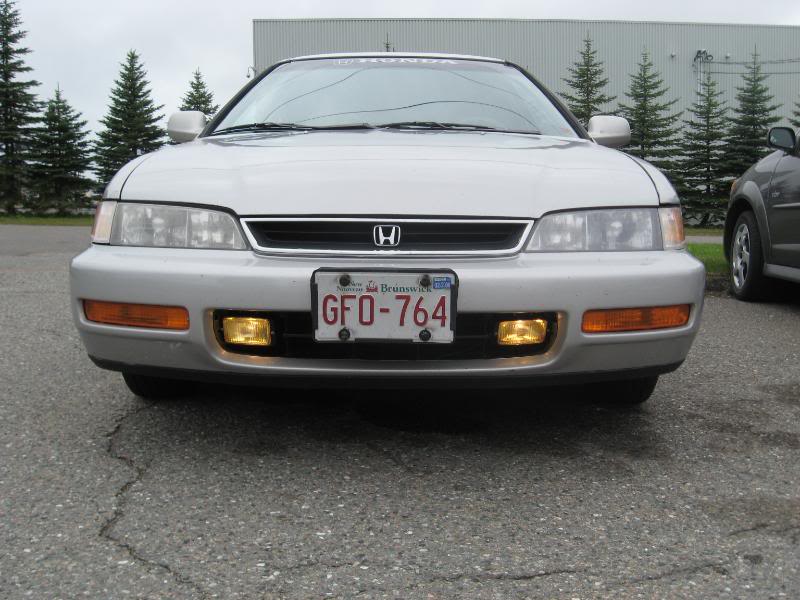

I just put some in my 96 EX, it was pretty easy.
I picked some up at Canadian Tire (you prolly don't know what that is) for like 35 bucks, they're the yellow ones and look pretty cool, they aren't top of the line or anything but I like the look.
Anyways, pretty easy to install, and I fit the switch in next to the cruise control button and it almost looks stock.
I cut some of the grille out of the lower portion of the bumper couver and bolted the lights to the ridgid plastic bumper, grounded them to the frame and did the wiring, pretty simple.
I'll post some pictures for ya.

Old Sep 14, 2008 | 12:24 PM
boonk
Default RE: Anyone installed their own fog lights?
