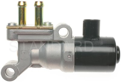

    Okay so I have a question that I cannot find an answer to. Does anyone know what the base model of the 1996 LX accord came with? I swear, none of the 94-97 accords (base, ex, or LX) have been without an ABS system, however mine seems to not have it. Did that come stock or was it an option that was not chosen at the time of purchase?
    I was just wondering because of the break problem. I also noticed that the black piece on the Idle control valve is slightly bent. here is a stock image of the one I have in my car. Could this be causing the idle problems? I'll go and take a picture of my part now and post that as well.

      #36
    That doesn't look good....I'm going to bet that is the idle issue. Check a bone yard for a replacement. Be sure to clean it reall well before installing. Also you will loose a bit of coolant so you will want to be sure the air is out of the system.

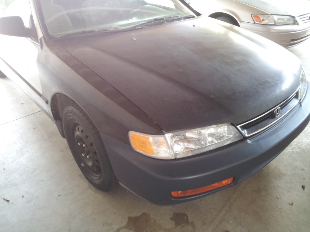

    The hood is up a little because the cable that releases the hood latch was messed up in the accident and if I shut it all the way the only way to release it is by fishing my hand behind the fender and pulling on the cable! (it was bent and the little clip that holds it in place in the latch was broken. (Not the thing on the end that goes into the mechanism, but the other one on the outside-ish part of the mechanism...if that makes sense)
    A little gap on this side...

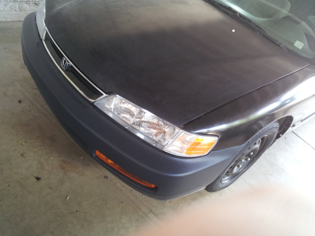

    Less on this side

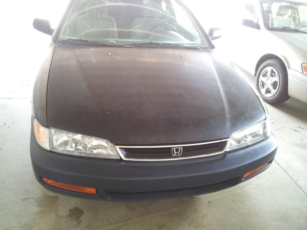

    And the complete front end.
