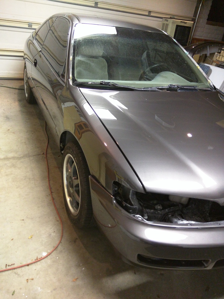

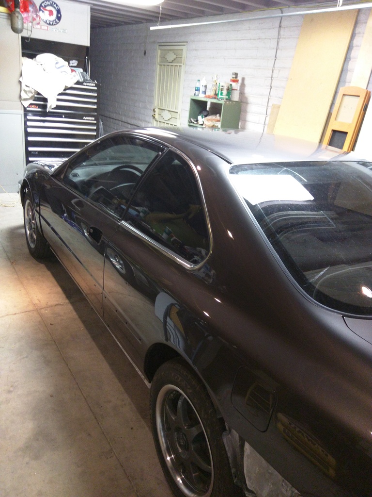

So, I finally got it painted!
I love the new color, I can't wait to put it back together.
Attached Thumbnails front end damage (working thread)-img_20150808_205348.jpg   front end damage (working thread)-img_20150808_205405.jpg
Old Aug 9, 2015 | 10:19 AM
  #67
That is looking really nice
