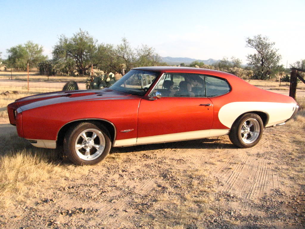

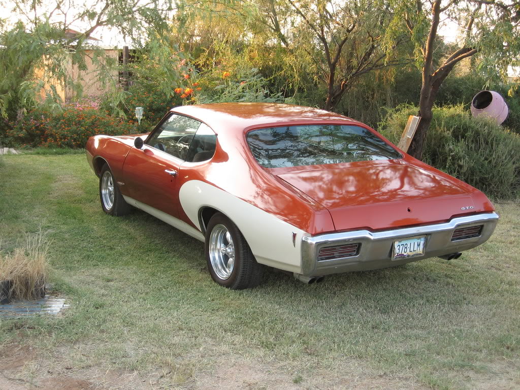

The next step after all of that is getting it painted. At my old house I was able to set up a paint booth (DIY style! plastic sheets in the garage and garage floor, close everything up and set the ceiling vent fan to HIGH and spray away) but this neighborhood would have the cops over so quickly...lol, So I must find a good priced either paint booth for rent or get a paint and body place to do it for me...I'm scared to ask for prices because I'll likely not be able to afford anything but a single coat plain white...with clear coat mixed in! lol Here is the car I helped paint a few years ago in the DIY booth.

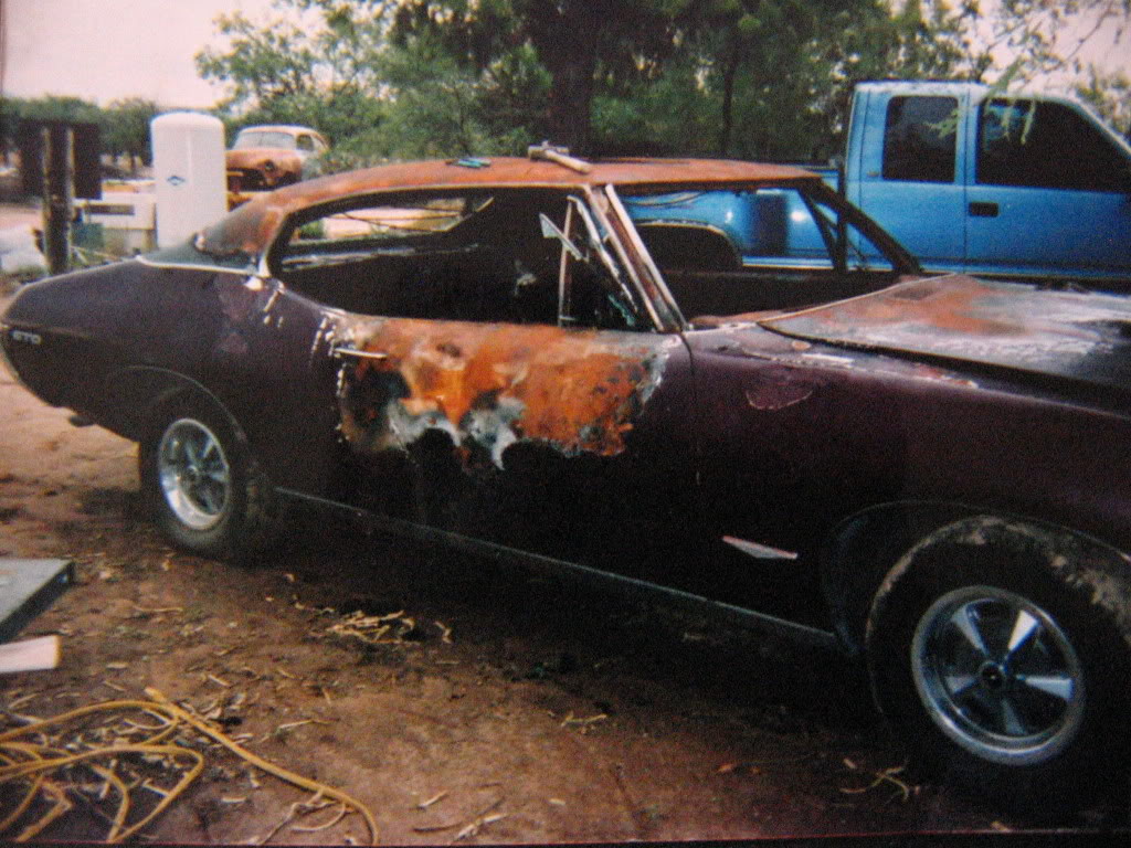

this is what it looked like before all the work!!!

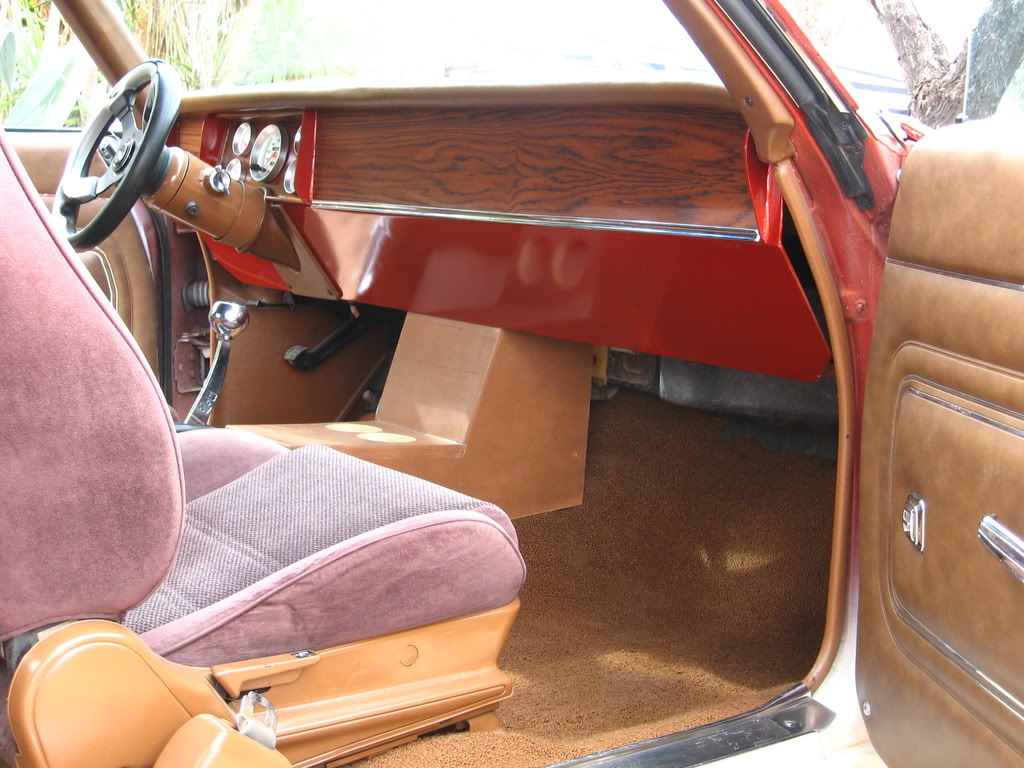

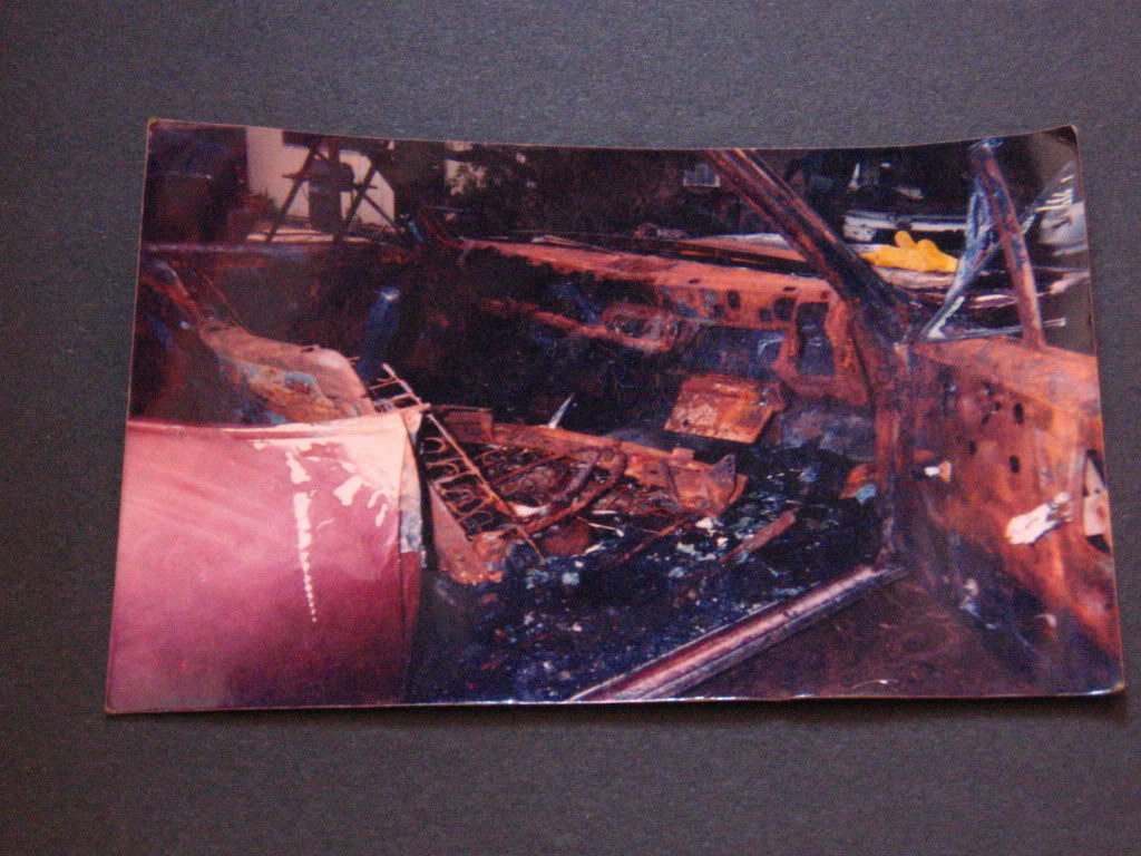

We ended up selling this car for $14,500 last year...and it wasn't anywhere near being finished. the carpet was in and the door panels but the headliner, trunk, deck lid, center console, and dash were not installed. (was a DIY wood console and metal dash because it was completely burned). This is the interior of the car before and after.
