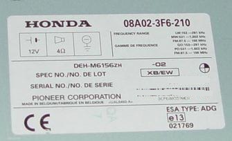

keep your Bose Equipment and just change the radio to a CRV-model with CD.
You will be more than surprised about the quality.
Get one for small money at EBay's; I bought mine for ~15 USD, same plugs, no problem to change and - I love to cruise with my Coupé more than before
Feel free to ask for better photos or more information by pm.
Btw, you can use a Disk Changer or a MP3-Changer with the other connector.

Hi Amicale504,
Sorry to bother you with this ancient post.
Maybe you can help me: I bought a (brand new) Honda Bose radio/cd MF721R0 (as on your picture) and want to use this in my CRX with regular speakers.
The radio and Cd works, recieves radiochannels etc. but unfortunately no sound :-(
Is it possible to use a Bose radio with regular speakers? Or can it only be used in a Bose equipped car (comes from an Acoord I believe)?
