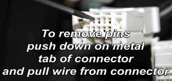

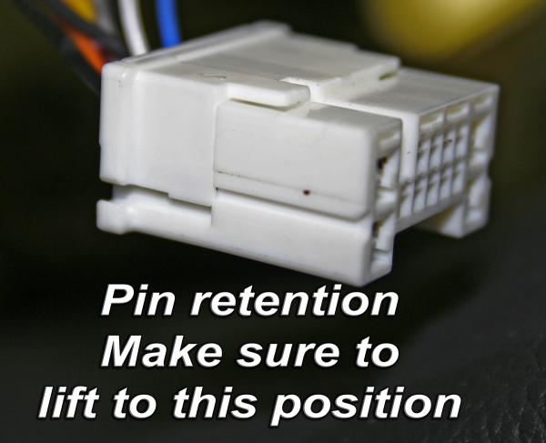

Read through what few post on the subject I could find and after some R&D came up with what I feel is the simplest way to disable the ANC.
First remove the drivers A-pillar, if you start at the top and get the air bag clip first then release the two lower clips then using a flat blade screw driver push down on the white part of the air bag clip while pulling up on the A-pillar you can remove the air bag clip without damage.
Near the dash you will see two plugs, unplug both and pull yourself some slack.
Remove the tape on the 14 pin plug to get to the wires. (see pic)
Now you can cut the wires if you like, but for me I'll just remove the pins from the plug.
You'll need a very small flat head screw driver to do this.
And you're done.
HunterG
Attached Thumbnails 2013 & 2014 Accord ANC disable with pictures-hunterg-69128-albums-2013-accord-anc-3447-picture-2013-accord-anc-mic-01-6905.jpg   2013 & 2014 Accord ANC disable with pictures-hunterg-69128-albums-2013-accord-anc-3447-picture-2013-accord-anc-mic-02-6904.jpg   2013 & 2014 Accord ANC disable with pictures-hunterg-69128-albums-2013-accord-anc-3447-picture-2013-accord-anc-mic-03-6903.jpg
