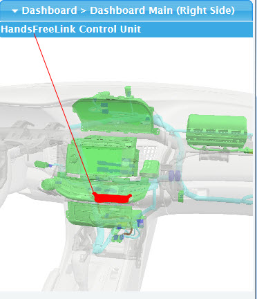

Originally Posted by berrnard
my anc is unplugged.
what year and model is yours? 2013s, the hfl sits below the anc under the radio. 2014s dont have an hfl unit below it.
did you unplug a mic? if so that is also the mic for bluetooth, i found that out from experience.
also i would put the LOC preamp if u have honda premium sound.
The 2014 Accord Sport, LX, and EX trim levels no longer have the Handsfree Control Unit (Bluetooth) hardware module. The 2014 Accord EX-L and Touring still has the Handsfree Control Unit (Bluetooth) hardware module.
