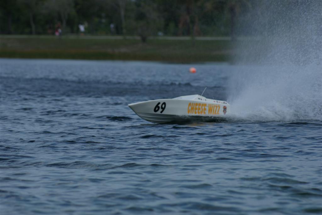

Here is a shot of my buddy's apache. The hulls is from the early to mid 80's and actually was one of the first gas powered model boats back in the day. He's redone is several times over the years, right now he is running a mid mod zenoah and runs in the 45mph to 50 mph range, and handle a serious chop.

Looking at your friends boat that hull is easy to build. Just makng sure to get the proportions right is the only tricky part,boats have a lot of R&D involved.Splashing is the best way to go and then add a twist if wanted. When you copy a fiberglass part (splash) you first wax it with a special wax. Then you spray on a coating of PVA mold release that protects the original part from resin. The PVA is key and is quite difficult to spray well because its so thin,like spraying water and trying to avoid runs. Then you can gelcoat over the PVA and finally lay cloth on the gelcoat. Make it good and thick because this becomes the mold. Let it cure in the sun and dont even think of removing it from the boat for a full 24 hours. Green or fresh fiberglass can distort if removed to fast. Then with your mold you wax it 3 to 5 times and spray on PVA carefully. Then You gelcoat it and lay up your glass and insert bulkheads and glass them right in. After 12 to 15 hours you can pop it out of the mold. Water disolves PVA so if something dosnt want to release you hit it with the garden hose and it will float out of the mold.

Well you have different classes of RC boats, you've got sport boats and race boats. The sport boats are more to scale and tend to be under 55 mph. While you can scale the hull down, you can not scale the water nor the physics down. So race hulls have been designed over the years for top speed, and handling at this scale. And they use very different techniques than the full scale guys do. Most races boat are over 60mph, with some hydro's and riggers close to 100mph. I think the world record for gas right now is 108mph in a rigger.
Splashing hulls is very frowned upon in this industry, so much time has gone into making the many different plugs and molds to finally get the final revision. And it would take a bit of work to get one these hulls to work as a good plug, as the manufacturers are using the same molds to pull countless hulls from, and fix them instead of replacing them. So the small defects in the original mold, are multiplied when you splash it. What the manufacturers do, to counteract the flaws in the molds, is they just blueprint the ride surface of each hull. Rockers and hooks are even worse on our small hulls then the full scales.
