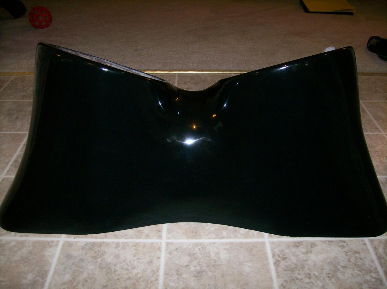

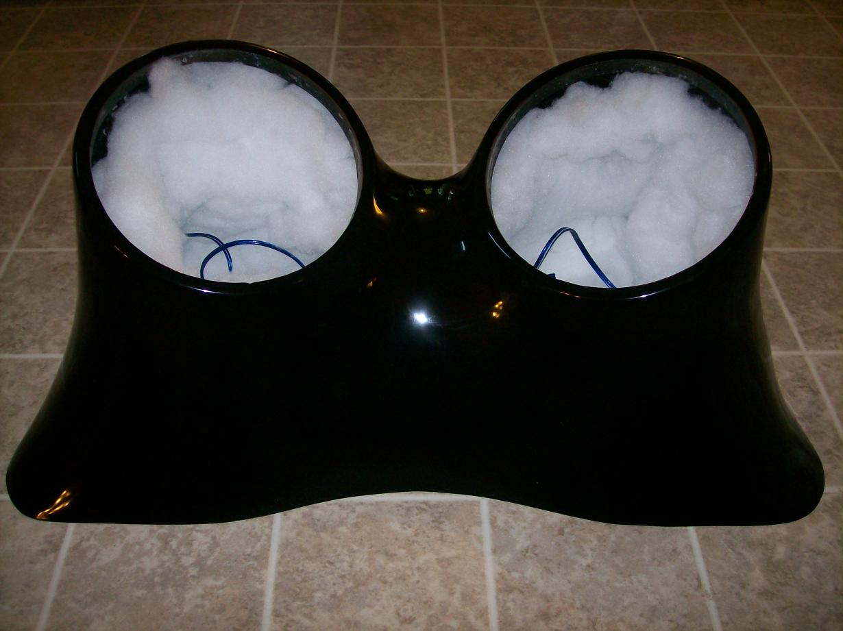

Finally finished my mold and here is a picture of the universal box I mentioned a while back. It holds 2 twelve inch subs. It also has a center divider making each side a seperate box,all wood is 3/4 mdf. Its not painted its polished black gelcoat! Much tougher than paint. I also gelcoated the bottom and brushed resin on all wooden areas making it weather proof and great for use on botas or outside. The terminals are gold plated and on the bottom. Wood rings are glassed in to screw the woofers into. The nice thing is the mdf absorbs resin making it very tough stuff. The polyfill helps it sound nice and dead. About 1.3 cubic feet per side. Also heres the original !998 - 2002 accord stealth box also.

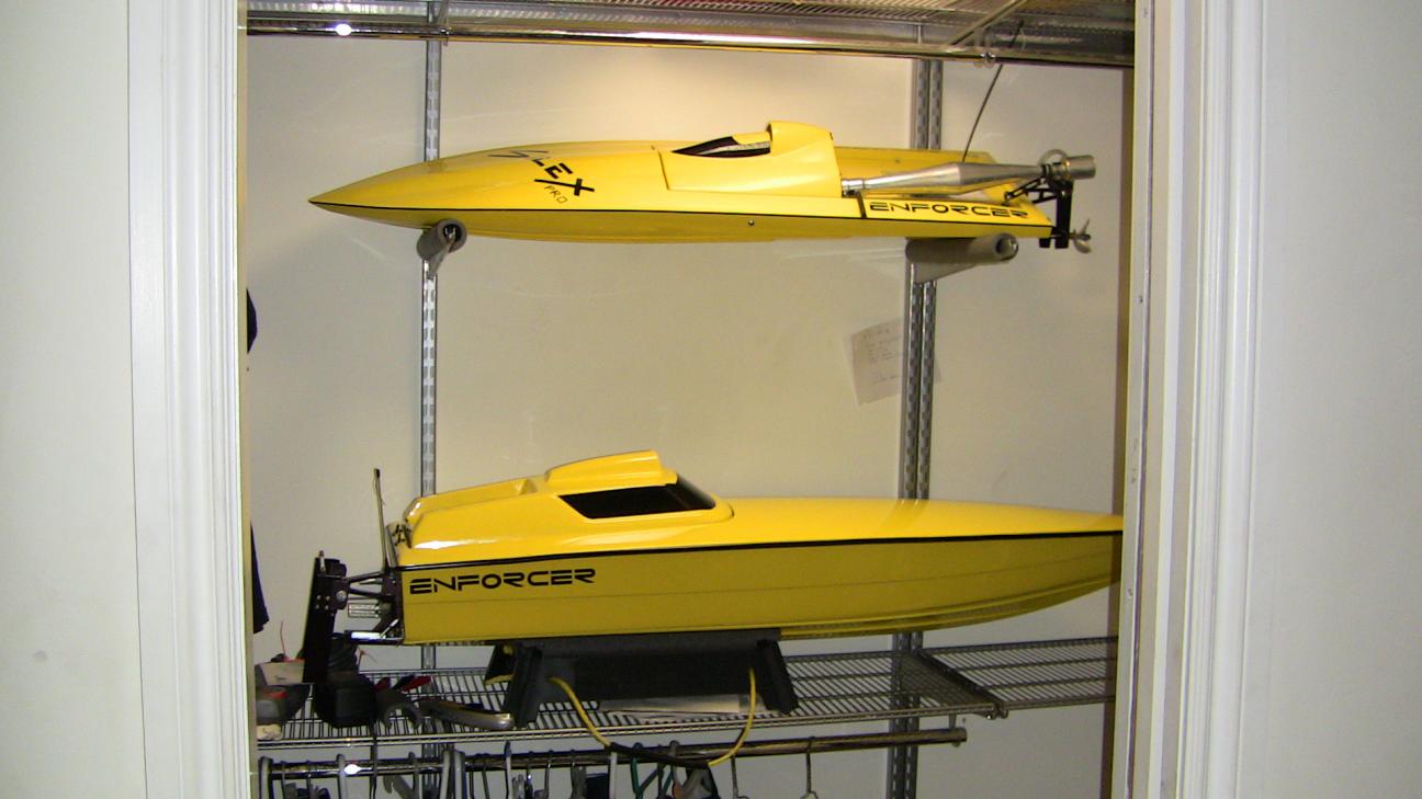

Do you have any specs on the hydro or mono? Who did you get them from? A good legit mold is really hard to come across, if it's a splashed hull you may have a hard time selling it. Hopefully it just some guys design that you can improve on. If you give me the name of the guy you got them from I can get some info on him and his practices. Check out Jim's R/C Boat Dock, it is THE 1/4 scale gas RC forum. Really the only way your going to sell enough of these if they are competitive race hulls, there isn't really a market for sport hulls. People who want a sport boat tend to want it RTR. But with enough trial and error, you can build a competitive hull. Also your marketing is based solely around word of mouth, so the hulls have to perform well with no bad habits to get recognized. It's really hard to start out and get recognized, especially right now. At the speeds we are running now it is not as easy to make a hull that performs, and there are some awesome boats out there right now.
I can tell you this though, there is a serious demand for American copies of the boats made over in Europe and Australia. People pay big bucks to get a PPB, MHZ, Sonic Racing, or viper hull shipped to the states. Recently this new guy got permission from sonic racing to produce some of their large cats (70"-110") here in the states. And he has had great business for just starting out, at first people were very weary of him. But it did not take long for him to gain momentum. I actually saw one of his 72" mystic cat with twin turbine engines at this months club race, it was so badass. There was this other guy that made a deal with PPB to make their dragcat over here in the states, well something happened, he only delivered a handful of the hulls he took orders for and ran off with peoples money. So maybe you could work out a deal with PPB and produce a US market drag cat. The drag cat is getting a lot of attention right now. Not many cats handle as well as it does and still run in the mid 70's to low 80's. This guy I know just spent over $10k to get get 4 PPB drag cats shipped here from Europe.
Sorry if I'm rambling I can talk about RC boats all day. There are quite a few guys who have their own molds and sell hulls locally. They don't make much profit, it's more of a hobby for them. But if your were to strike a deal with one of these overseas manufacturers, it could be your sole source of income. Well I'll leave you with a shot of my two monos so you can see the difference between a deep V and a race mono. I can get a shot of ride surface if you want. The sharp V goes right back to the transom, and the last 8" or so of the keel is flat about 2" wide at the widest point. At speed this is the only surface that is touching the water, trimmed right you will only have the prop in the water.

Not a word about the new shiny black box? I busted my butt making that mold! The hydroplane mold is the original mold and I would also be getting the matching plug with it. When you get the plug you know your buying it from the maker. Also Im buying this from a company in S.C. that made full size boat parts and went out of business recently. The hydro is a pickle fork design and 3 pieces total. Bottom hull,deck and a canopy. The deep V I havnt seen yet. The man I am buying from is very honest and was going to retire soon but going out of business forced him into it sooner. Money was not a problem for him,I will check but I really doubt he splashed anything. I think I can make these very reasonably priced and they would be great starter boats for someone on a budget. I know the deep V is fairly simple and I could probally sell a complete hull thats finished in nice shiny gelcoat but unassembled for 125.00. The hydro probally around 150.00. It will most likely be a week or so before I drive down to S.C. and buy the molds and plugs so I wont have pictures for a while. That new box sounds great a customer stopped by with a pair of kicker CVX's in his and it looked hot and sounded great. The polyfill really helps the glass boxes to sound completely dead like MDF. If anyone wants one of those boxes I can make them a great deal. http://cgi.ebay.com/ebaymotors/ws/eB...#ht_500wt_1182

Ok, Ok sorry for going off again lol. I love the box, and I wish I had the money to have you make me a sexy single box. If I would have known about your boxes a year ago I would have had you build me a box for my boat, but the MDF box I built is holding up well, like you said it just soaks up resin.
