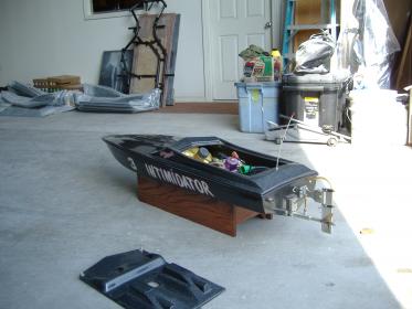

This is the V hull its called the Stinger Deep V and is 51 inches long with a 13.5 beam. I thought it was shorter.

The mono looks good, that is a nice size not too big but will still handle a good chop. It's definitely got a zenoah either G231 or a G260, most likely it's a g260. Might even be lightly modded since it's got an aftermarket water jacket. Set up right that hull should run about 40mph with a stock motor and a dry tuned pipe. One thing that concerns me is the length of the stinger(outdirve), that is way too long for a mono. You want it out far enough so it's in clean water, too far out and you can run into handling problems. Rudder bracket is too short for that stinger, you want the rudder to either be inline with the prop or further back, to far in like that and it won't handle as well in a turn.
Couple important things to know, if it has a champion plug toss it out. Get a NGK plug, the champions are known to fail and destroy your motor. Make sure the flex cable is good, any broken strands don't use it. Make sure the prop has been worked on, if the prop hasn't been balanced you can really mess up the drive line. Make sure the water lines are clear by blowing through them, doesn't take more than a minute to overheat the motor. Most importantly make sure you use a failsafe, and tie warp the connectors on the radio system. If something unplugs or you loose power to the radio, your going to loose control of it and it will crash. I use a failsafe and an EKG that kills the motor if there is power loss. There's really a bunch of other small things to check that I just can;t think of right now.
EDIT: Most important, run at least 8oz of synthetic oil to a gallon. A lot of people try to run less and these motors don't like that. Even stock the motor turns 12,000rpm under a load. At 8-10oz per gallon the needle bearings will last a lot longer, and the chance of catching a ring is less. Amsoil saber and honda Hp-2 are the best oils to use.

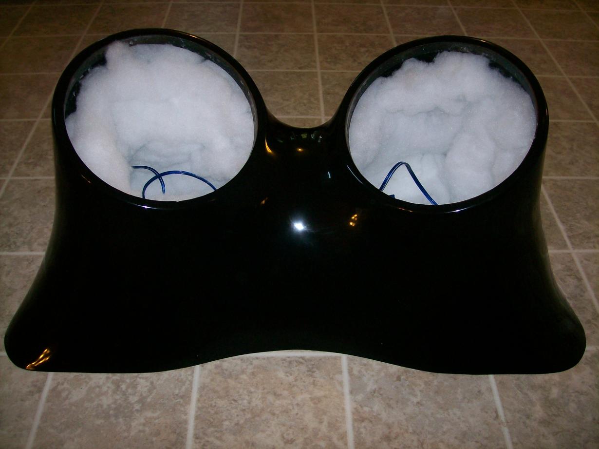

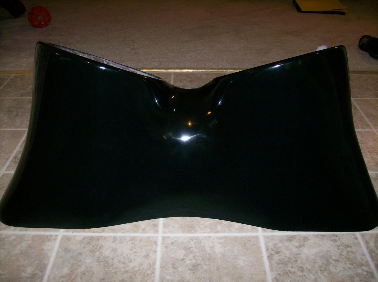

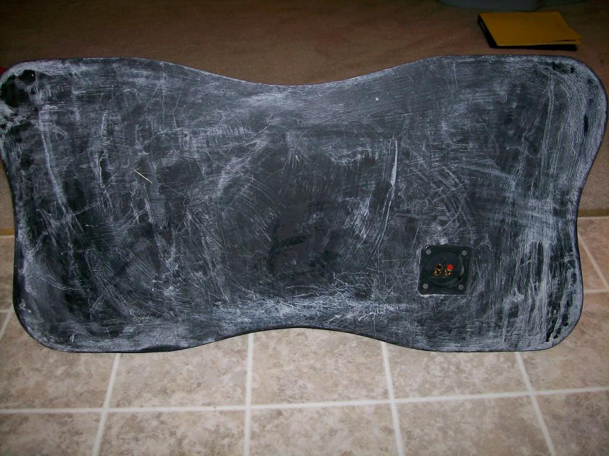

Now thats a nice how to article.I do know most of what he's doing but the lay up schedule and his daring test of the TR wax are helpful. I still am a avid PVA user. After you stick a mold you have a real hard time not using pva. Most people wont know what Im talking about but PVA is a spray on mold release thats like liquid saran wrap. You spray it on and it tints the mold green. It dries fast and can be peeled away easily like a big piece of plastic wrap. It makes release much easier and pretty much guarantees a release. Spending 100 + hours sweating,bleeding and pulling glass slivers out of your hands only to have a mold stick because you did not use PVA royally sucks! A lot of professionals won't admit to ever sticking a mold,but all of them have unless they are new to glassing. I think its a pride thing. I have another speaker plug almost done,this one is unique. Its a front panel thats contoured and holds 2 twelve inch subs. Its for the DIY'er you buy the panel and then build your own box for it. Its designed to slip over a MDF box and is held on with gorilla glue,screws are optional. That gorilla glue is tough stuff and once cured overnight you'll never have a air leak or be able to remove the front. Its also affordable. I will have the DIY panel popped off my plug before the weeks over and up for sale asap. Right now I still have 1 of the polished black gel coat boxes available. The other 2 I built sold instantly locally. Once people saw it and picked it up seeing the weight,build quality etc etc they sold themselves. Its hard to get a good angle to take a picture of this box. It also sounds good and hits hard with 1.4 cubic feet per side. The middle is sealed with a mdf panel and glass making each side a separate airtight box. The bottom is a full 3/4 thick piece of MDF with a recessed terminal cup. I gelcoated the bottom so its completely waterproof if you install marine subs. I figured that was a nice feature making it good for boat use,outside use,or jeeps. Its absolutely ridgid because of the curves and wood panels glassed in wont flex anywhere at all. The woofers screw into MDF rings thats glassed in while building the box. The woofer opening is 11 1/8 inch,perfect for kicker CVR or CVX subs. Most good 12 inch subs use 11 1/8" openings. I bought a circle cutter for my plunge router and can make perfect rings,I like things to fit nice. I also am a bit of a perfectionist. The pictures don't do this box justice at all,you could shave in your reflection. Getting black gelcoat that shiny is a TON of work. But the beauty of gelcoat is it dosnt chip easy like paint and has tons of UV resistance. It wont fade in the sun like paint,at least not for a very long time. I am getting the boat molds tomorrow and will post pics asap. It may take me a couple days as I have to get some of the DIY panels built asap.
Attached Thumbnails Accord Fiberglass Stealth  Sub Box Project-100_0888.jpg   Accord Fiberglass Stealth  Sub Box Project-100_0891.jpg   Accord Fiberglass Stealth  Sub Box Project-100_0892.jpg
