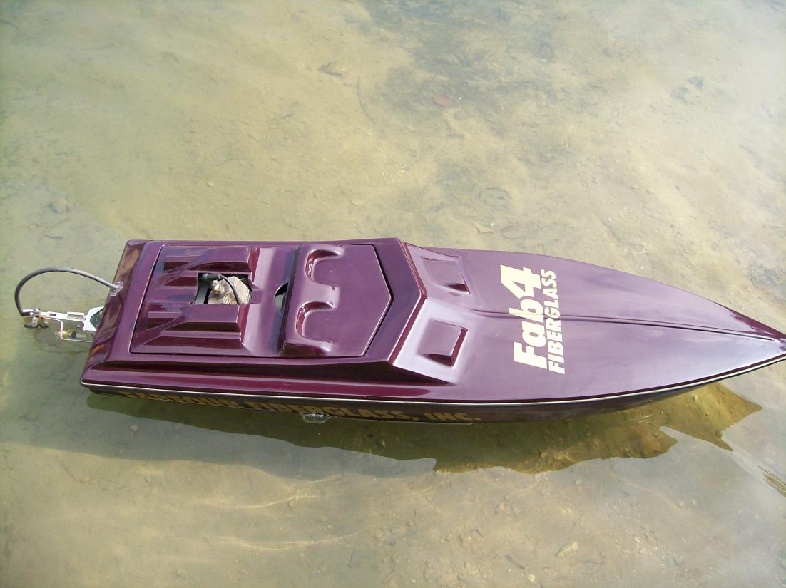

Heres a couple shots of the v hull at the lake. I never got it up to full speed but it was starting to get moving fairly quickly. I know it would be a blast in some chop,the water was glass smooth that day. It looks simular to most v hulls. I like the fact that it has really nice sharp lines on the bottom of the hull and its laid up a bit on the heavy side so it can take any abuse you can give it. Good general purpose boat. The cat is more of a speed boat,designed for higher speeds and may not corner as well. The carb in this v hull is a walbro with no choke or primer bulb. Not even a air filter. It has a weird rigged together thru hull exhaust thats basically a straight pipe. I don't like the way the exhaust was built,I didnt make it. I am a perfectionist and make high quality stuff. I would rather make fewer products and sell fewer but make them top quality. My name goes into everything I produce and I take a great deal of pride in that.

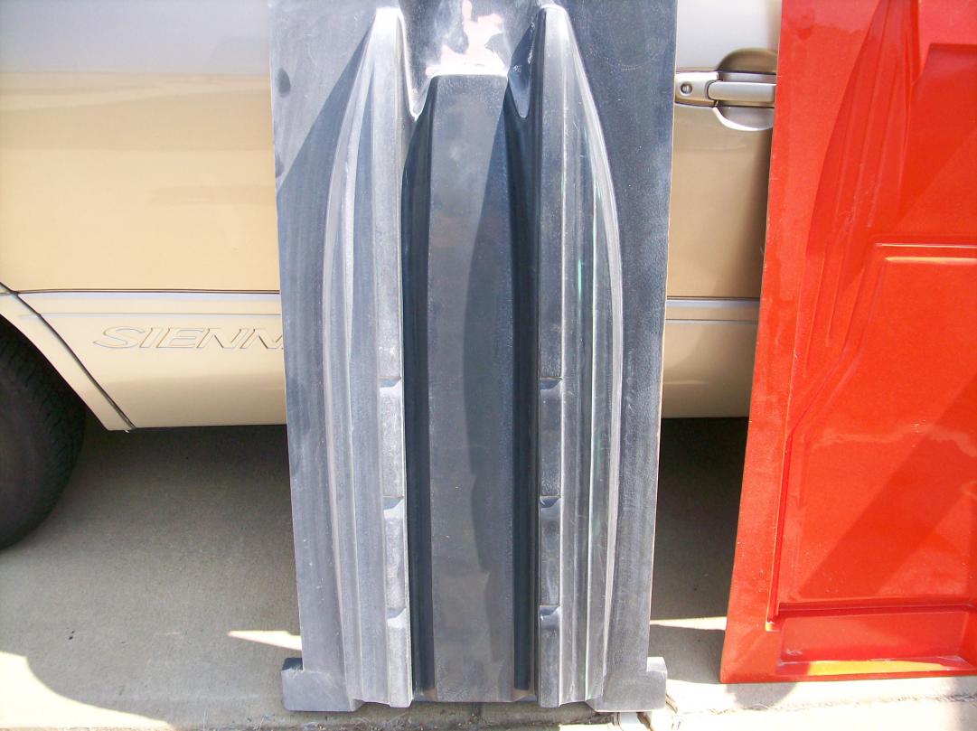

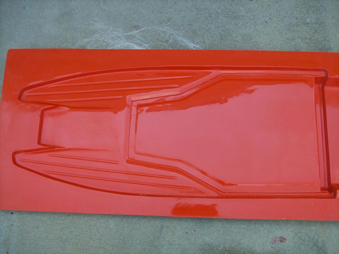

This is the mold for the deck on the cat style boat. I have spent a lot of time wet sanding out inperfections with a mini sanding block. I started with 220 then 320,400,500,600,800,1,000 and finally 2000. Then buffed it back to a mirror shine with aquabuff compound designed for gelcoat.

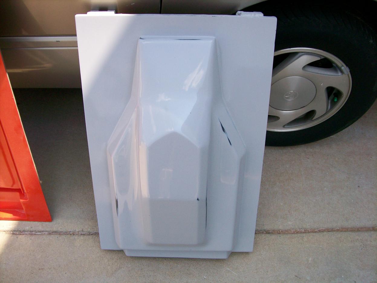

These are actually plugs that molds are made from. They are carved from solid wood and weigh 50+ pounds each. Making these takes a ton of time. I have wet sanded both ,the canopy plug is nearly ready. As you can see I still have to gelcoat the hull plug and wetsand /buff it. I would rather get it perfect now than fix it later. The nicer I make the plugs the better my molds will be. I also am using sanding blocks the sand out blemishes and any slight hooks or rockers to make the best hull I possibly can. I have about 100 hours into these already. Another 60 and they should be ready to produce actual molds.

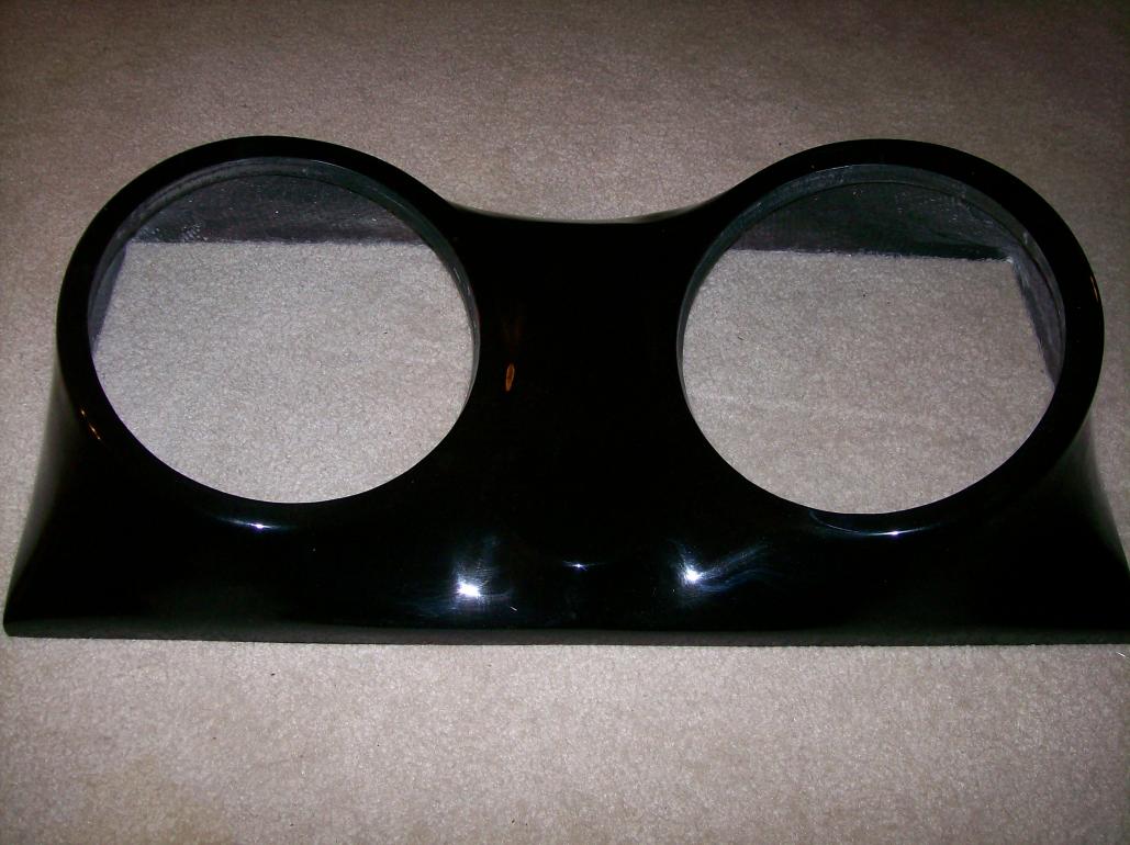

Newest speaker product. This is a plate for the diy'er that holds two 12 inch subs. You build your own box the size you need and mount this front plate onto it. This allows you to mount the plate at a angle or build the box and amp rack into a unit and have the plate shown off that way. The woofer openings are 11 1/8 inch. I made these with mat and 2 layers of 24 ounce roving on the back side. Very heavy duty! Glass is about 1/4 inch thick. This one is painted black and buffed out so you could shave in it if you wanted. These can be painted any color. They also are cheaper than my complete box and easier to ship. These allow a lot of flexibility,anything can be done with them. Only limited by your own creativity. Also the wooden MDF rings are glassed right in for the woofers to screw into. These are completely waterproof and can be used in boats. Since I made the plug and mold for this they are not available anywhere else. I've searched very few products like this anywhere,the one I found is no longer made. Anyone who wants one can email me direct at Azenis29@aol.com

Sorry heres the picture
