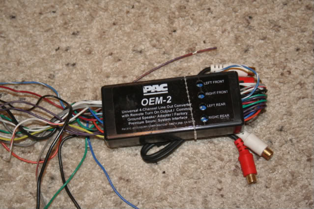

I have a RCA aux input hooked up in my car but i want to add an amplifier in but i am still using the factory head unit. i am looking to purchase this (HILO PAC AOEM-HON20 Amplifier integration interface for Honda vehicles OEM-1 with a vehicle specific harness plugs into the vehicle\'s wiring and offers a 4 channel RCA audio output for adding aftermarket amplification. Provides full range audio outp) which will allow me to run a RCA cable from the amp to the head unit. Will this interfere with the AUX input i already have installed?

you mean like this one? that i just happen to have lying around and have no use for.

yea tht looks about the right.

The item pictured above is universal, you will need both 70-1721 & 71-1721 Metra harnesses to interface wiring so you dont cut factory wiring. The HON20 has matching factory harnesses to greatly simplify installation.
