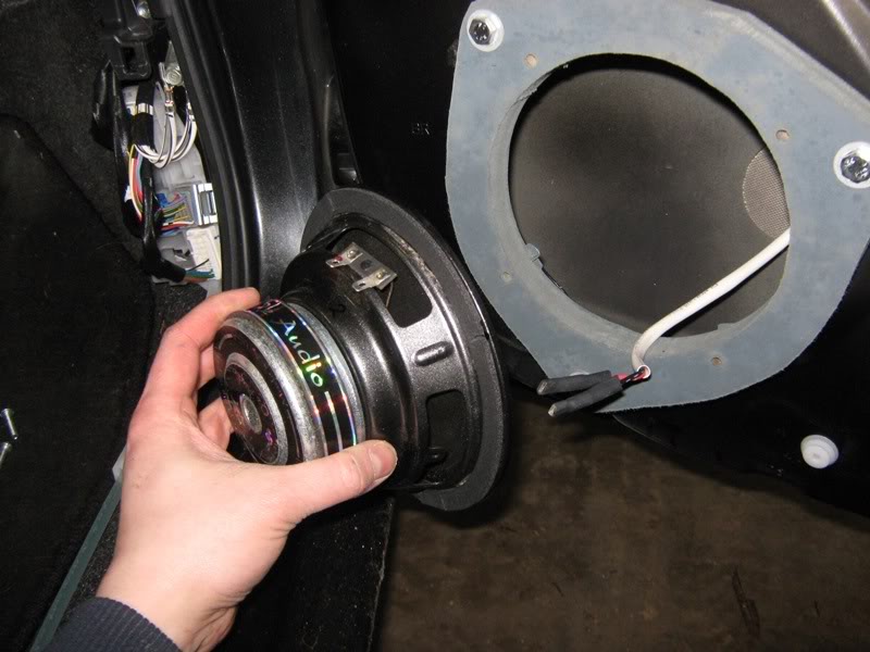

you need to put proper terminations at all of your speakers.
i use .250 female disconnects (or other sizes depending on the speaker). i crimp them to the speaker wires. When inserting the wire, i double it over, then crimp tightly so i cannot pull off the terminal. then i use heat shrink over top of everything. lastly, i use pliers to close the disconnects so they fit tightly on the speaker terminals. Here you can also see the MDF ring i made to mount the driver and the foam between driver and baffle. Like so (from a friends 2008 Scion xB I did):

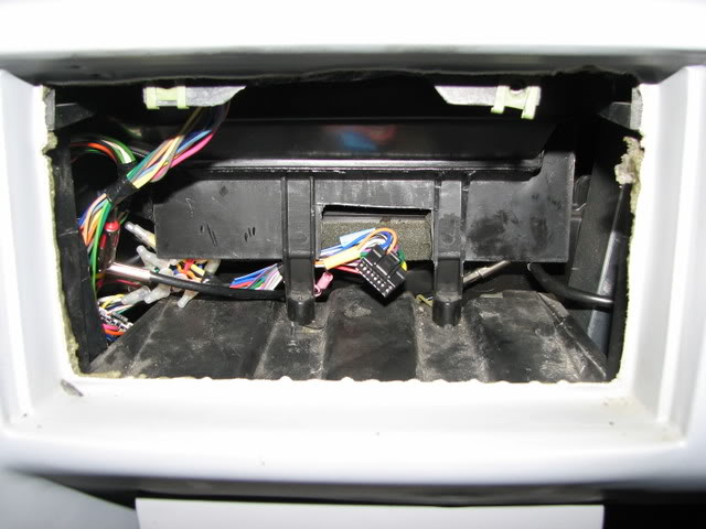

this is one method of securing the head unit wiring - using nylon closed end caps.
and it routed neatly behind the HU to minimize damage (my dad's 1990 Deville has no depth)
