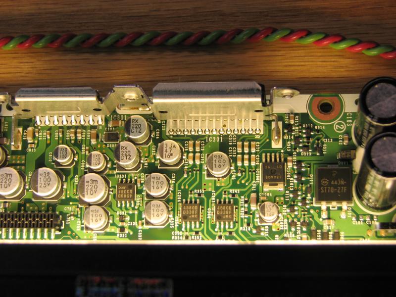

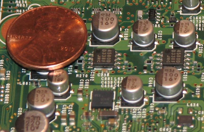

power is about 5-10watts, same as any aftermarket. while the aftermarket says "22w" you'll never see that because that's at very high distortion. the amplifier chip is about the size of a quarter regardless. Panasonic makes the factory head unit and back then, Panasonic made a decent product.
This is what the inside of a head unit looks like, the 25-pin vertical chip on the right is the 4 channel amplifier.
penny for scale
the car sounds good because the factory speakers are actually decent, not because the head unit is great. an aftermarket head unit will greatly outperform the stock. and you can add bluetooth for hands free calling.
