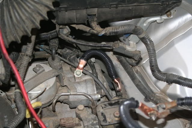

Bringing this thread back to life with a question. I have an 07 Accord and was wondering if there is a video tutorial on doing this upgrade. I comprehend the alt to battery cable and battery to ground cable. But I am not understanding the engine block ground cable, or even where this stock cable is located. I am putting in a 1000W RMS amp so I believe this will be a must.
Old Jan 11, 2012 | 03:44 PM
  #55
neophyte's Avatar
Joined: Feb 2011
Posts: 862
From: louisiana
your factory engine to ground:
pull your battery and battery box.
pull your air box.
it is right there. I will post a pic momentarily.

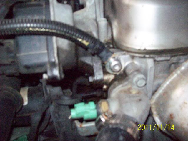

Here is how I ran my ground to frame, do not over think it, you just need to add another ground from the motor (anywhere) to the frame (anywhere)

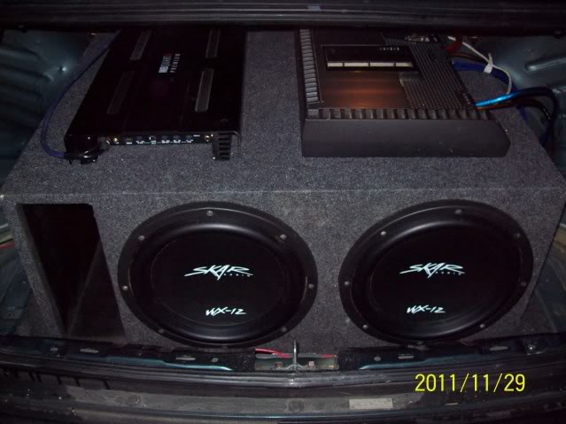

Here is my setup. That is a 1,500 watt Fosgate amp and a 400 watt MB Quart amp.
I am running an HO alt and the stock battery. I have a volt meter installed where the ashtray used to go. I stay over 13 volts almost all the time.
