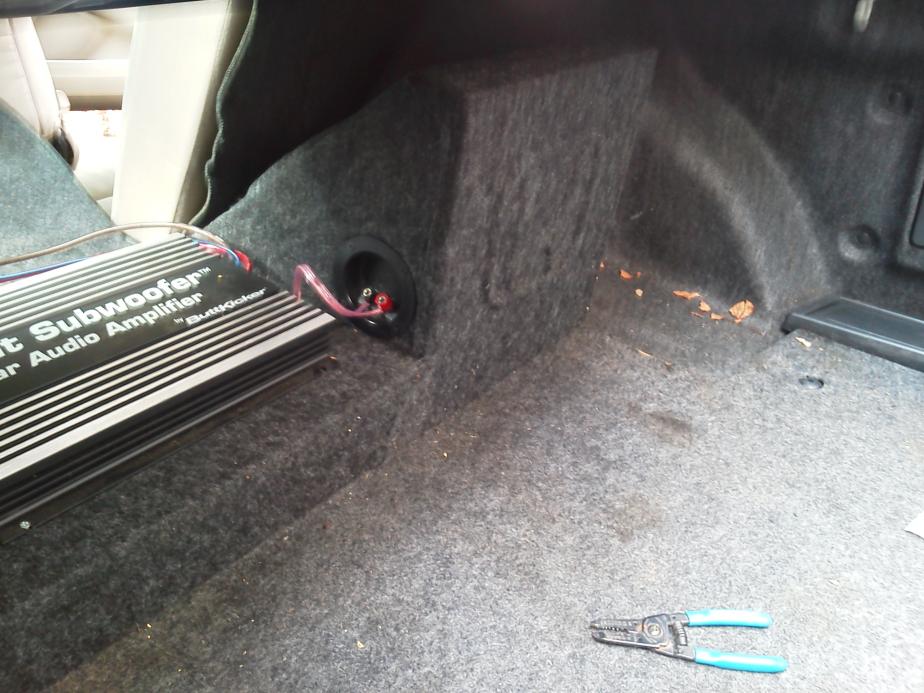

Several years ago a friend gave me a 12" Polk Audio MOMO subwoofer. I really had no use for it at the time but I bagged it and stored it in my garage for a rainy day. Well, when I bout my 2001 Accord, I figured it was at least getting cloudy and pulled the sub off the shelf to see what I could do.
First thing I noticed was that the enclosure wouldn't work in my trunk. There was no way I could fit it in and still have access to the spare tire. So, I measured out a box that would fit up against the rear seat and still allow me to access the spare tire normally.
I ran into another issue there. A large enough enclosure would also block access from the trunk into the cabin. So I drew up an enclosure that would fit behind the passenger-side rear seat with a lower section that spanned the entire trunk. That gave me an internal volume of .91 cuft. It also provided a nice mounting platform for the amp. (Which I bought from a friend for $50)
The whole thing fits nicely against the rear seat, I have plenty of room in the trunk and the access from the cabin to the trunk is nearly unobstructed on the driver's side.
This is the view from the cabin with both rear seats folded down.
Attached Thumbnails Custom sub/amp-sub-1.jpg

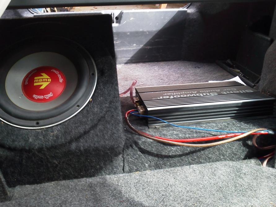

Here's what it looks like from the trunk:
Attached Thumbnails Custom sub/amp-sub-3.jpg
