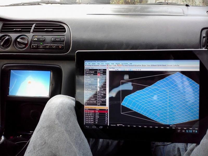

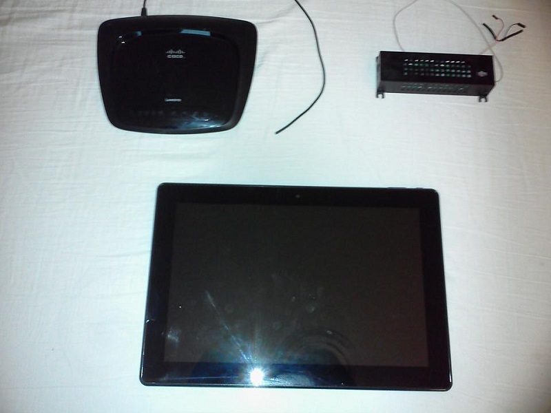

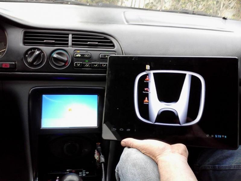

My car has an aem ems-4 ecu and i am always making real-time adjustments with aemtuner. i built a carpc and installed it in my car so i would not have to ride around with a laptop, but the 7" screen is hard on the eyes trying to use tuning software while i drive(real-time). and the 17" laptop is just cumbersome and the usb cable always gets in my way. oh and aem tuner only runs in a windows environment. this is my problem/motivation.
the installation of a router was simple. an intelligent dc-dc power supply programmed to give the proper voltage to the router eliminates the need for an inverter. i ran a cat6 Ethernet cable from my carpc to the router. and that was pretty much it for the hardware installation. then i took a 13.3" android 4.1 tablet, downloaded a remote desktop app that works with windows remote desktop protocol($15 @ google playstore) connected my tablets wifi to my car's router(no internet), and entered my carpc's ip address into the tablet's app and suddenly i can run windows only aemtuner on my android tablet for wifi real time tuning. also my car is now my large wireless thumbstick, lol. and wifi file sharing with tablet(s), laptop(s), and cellphone(s), and all the other good stuff that comes along with having a home network. that is, a CarNetwork
