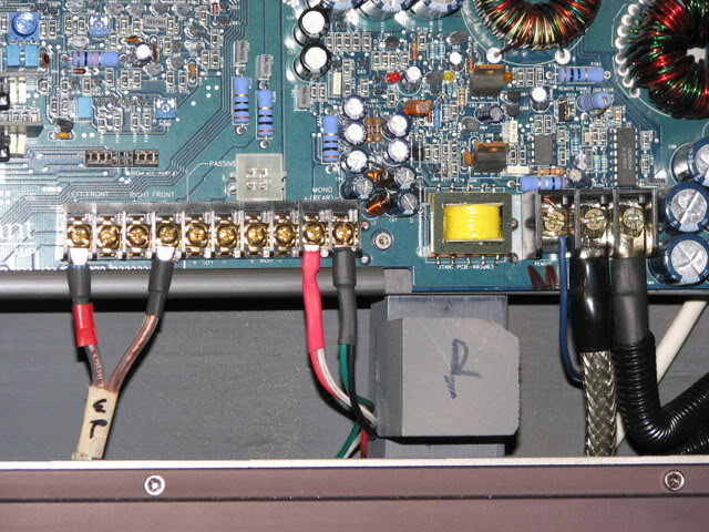

12 gauge. use spade terminals at the amp. heat shrink or tape the ends. like these:

the pics above are from some of my installs. the top one has 4 awg back to a distribution to 8awg for power and ground. neither amp draws more than 60A so 8awg was fine. 12awg was used for speakers.
the middle pic is a close up of a spade terminal connection for a processor.
the bottom pic is another amp termination pic. you can see that i use spade terminals and heat shrink or covers.
