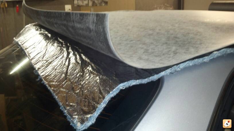

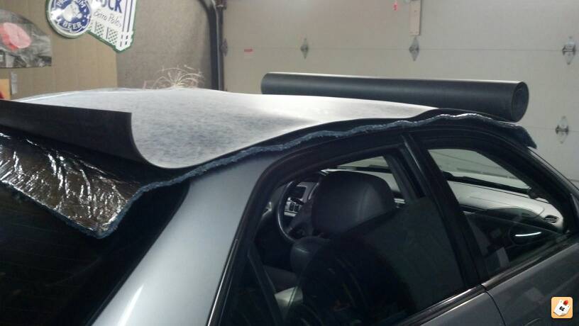

Found some MLV and the perfect de-coupling product at Home Depot. My local store didn't carry it but free shipping online.
dB-3 4 ft. x 8 ft. Acoustical Barrier-DB348X96BX at The Home Depot
4'x8' is enough to do a floor, $30
i got two of them to ensure rear seat and wheel wells.
but you need to decouple the product, that's where ultratouch thermal barrier comes in
UltraTouch 48 in. x 6 ft. Radiant Barrier-30000-11406 at The Home Depot
i noticed my floor gets hot from the exhaust, so this will help that as well. this would also be well suited on the roof to keep a car cooler in the summer (assuming you tint your windows and cover the windshield).
for extra fill in cavities, these bags will do the trick:
UltraTouch 16 in. x 48 in. Denim Insulation Multi-Purpose Roll-60301-16482 at The Home Depot
note that i'm not going to use CCF. CCF is fine for rattles and since it doesn't compress it is a thin decoupler, but CCF isn't absorptive.
The ultratouch blanket insulation is an excellent absorber, and will compress but will still decouple. I expect better results with this blanket than standard CCF.
to adhere the blanket to the roof i would just use spray glue, but keep the foil facing the inside. the blanket is lightweight so spray glue to tack it in place, then replace headliner. this will also improve absorption inside the car for improved acoustics.
The MLV package says .75 lb/sf but then says the 32sq. ft. package is 32 lbs. i know they make 1/2 lb/sf and 1 lb/sf. i assume it's the latter. there was a negative review where the guy sandwiched it between two layers of drywall - well no **** it didn't work, it's a limp mass barrier - the "limp" part is crucial. had that person put the MLV on the inside where it could be loose, he would have seen a marked improvement.
MLV came in. 0.75 lb/sq.ft. still cheaper than the 0.50 lb/sq.ft. i have found which was $140 for 100sq.ft. shipped.
looks decent. once i get the insulating blankets i'll lay it down. i have about 125 sq.ft. coming. i have a lot of uses for them
I got way more than I needed to do the floor. This just one of two rolls, $50 shipped for what you see.
Looks like I will be doing both my cars.

installed and a huge different was made. i'm very happy. much quieter.
deadener on metal to lower resonance. minimum 25% coverage, I prefer as much as you can afford.
radiant barrier on top of deadener/metal to decouple the MLV and reduce heat transfer. radiant barrier should be 100% coverage. i use aluminum foil tape to hold the radiant barrier down.
MLV on top of radiant barrier. MLV should be 100% coverage. MLV should not touch metal. seams are inevitable since it won't bend. seams should be closed with a thick tape (like gorilla tape). i don't show my seals in the pics above. 100% is not possible since you cannot cover where the seats bolt down, or on top of the transmission hump crap. so cover as much as you possibly can.
