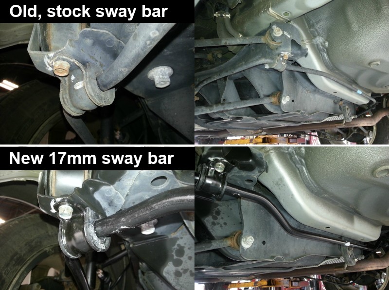

Next up I wanted to do some basic modifications to it. First thing I noticed was handling...it sucked. Lots of roll on corners, very unstable. I read up and came to conclusion that since I wasn't going to drop my car, ever (sorry, keeping it stealth stock ) that I wouldn't need anything over a 17mm sway bar in the rear, since I'm keeping front stock.
So...
17mm Sway Bar
I stripped both end link hex bolts... Nothing a little ingenuity and a pair of vice grips couldn't fix

I have to say, although minor in daily driving...it feels a lot better!

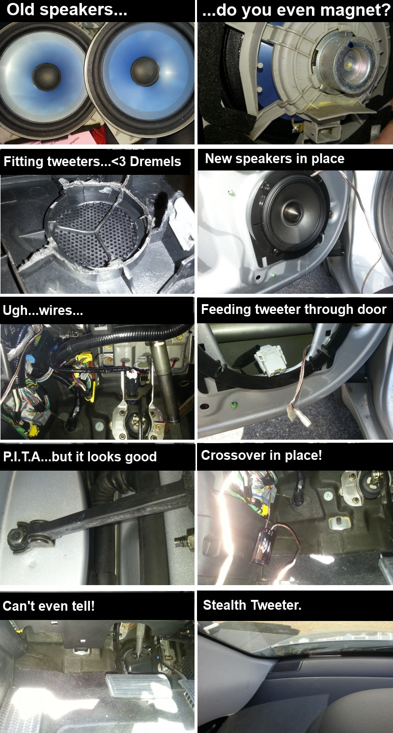

But now I thought, man...these speakers suck. So I went off and got new ones! Phase I of audio is just new speakers...I want to keep my stock HU, so once I save up and get back to my main home (stationed elsewhere at the moment) I'll put in the money and work to put in a cleansweep, amp and sub.
SPR-50C
Decided to do it stealth, and do it right. I know, I know...stock tweeter location is bleh, but I made it work and I put the effort in to make it look nice. Wired through that tiny *** little rubber thing between the door...pain, in, my, ***! But it looks nice and is protected. Crossovers are now inside and readily available if needed.

cool. be sure to go back into the doors to add foam weatherstripping around the front of the speaker basket to get an airtight seal against the plastic door panel. that will give you much better midbass response (since the plastic panel acts as the front baffle).
