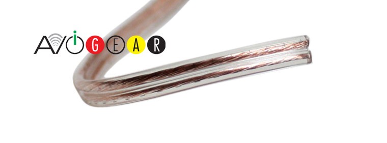

What's the speaker wire look like and how do I connect it? Also, is it bad if I run the speaker wire next to the power wire? I don't want to mess with the currents.

It will look something like that. it will be two wires stuck together. on the amp side you will strip a bit back and tighten the copper down under the plate. on the speaker end you will need some speaker quick disconnects. you can grab them at walmart or any parts store.
it will connect on the post of the speaker.
the wire will be marked. it will have a stripe on one wire or something to that extent. you may have to pick up some more. I dont know how much was included in the kit but the accords are not small cars. you can get more at lowes if you need it. make sure that you connect the wire from the positive on the amp to the positve on the speaker, otherwise you will get cancellation from speakers being out of phase.
as far as a current field causing noise, the chances are that you will not run into any of that. Keep the RCA's opposite side just in case, but over the speaker wire, chances are slim. The electrical environement of the car is so hostile that avoiding all electrical fields would be impossible. but nothing in the car should bleed into another line. there shouldnt be that much current. if you get a loop is more likely a grounding issue.
