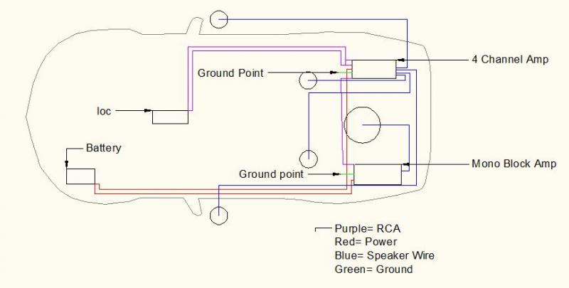

Okay cool. It's makes sense now. I understand how to LOC outputs two kinds of rcas for the 4 channel amp but what RCA do I connect to the mono amp? And about the speakers in the front, where is the wire that I should split?

the amp has a summed pre-out. you can use a short set of rcas to run from the alpine amp to the other.

I don't want to lose my fade ability. What LOC do you recommend?
And where would i put it, and to what does it connect to? I know the first LOC i put in changes the signals for all of the speakers, so what am i going to do from there?
Does this take care of connecting the speakers to the 4 channel amp.

oh, I was thinking I had told you a different loc. that one will take care of what you need without the need of a second loc and you can keep your fade. it has front and rear built in one. according to crutchfield they should be marked on the rca outs. lf= left front. rf= right front, lr=left rear, rr= right rear.
then from the alpine amp you can run to the other amp.
sorry if I confused you. I was mistaken.
just to clarify.
you connected all you high level outputs to that loc. you should be able to run two rca cables to the trunk from that loc. one set for front speakers, one set for rear speakers. this will send signal for all speakers and allow you to keep all factory functions. then from the alpine amp you have a set of preouts. you can run an rca from those preouts to the second amp. and this should give you a signal for your sub.
again, so sorry for any confusion. I was thinking I had just listed a two channel loc.

So I don't need to run cables from the alpine amp to the speakers?

you will have to run the rca's to the amp. and then run speaker wire from the amp to the speakers.
Hopefully this helps. (I forgot the remote, just run it same path as the RCA's)
and the locations for amps are for drawing space they do not have to be opposite sides of the trunk like that.
I can also remove layers and do it just one step at a time if it would help. just let me know.
