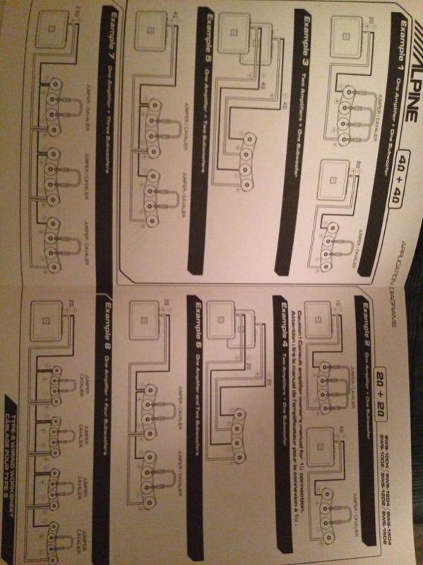

Thank you for the guidance on the LOC. I picked up a Ported box from Sound Ordinance. I'm setting it up right now but I don't know how ohms means or how to connect it to the box. Can you guide me on what diagram to follow or the connections I need to do. I'm trying to attach pictures but it won't let me. What I have on the sub is two red and two black push terminals. At what ohms do I set it, and how do I connect it to the positive and negative cables of the box?

what amp and sub did you go with? ohms are the nominal resitance of the coils on the subwoofer. you have two of each terminal because you have two coils. It looks like you have dual 4s. so you are going to want to wire them in parrallel.
this video show parrallel and series. do it the parrallel way.

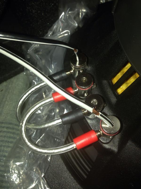

Is this good? I attached a picture. The black push down terminals are negative and the red are positive. The jumpers I assume have no polarity. And the black wire with the grey line is negative, and the grey wire with the black line is positive.

yes that is correct. if you have a cup terminal in the box. connect the white wire to the positive on that and the black to the negative

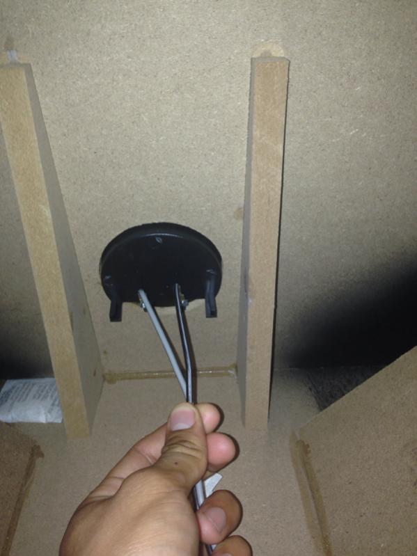

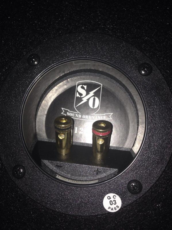

Is this what you're talking about?
