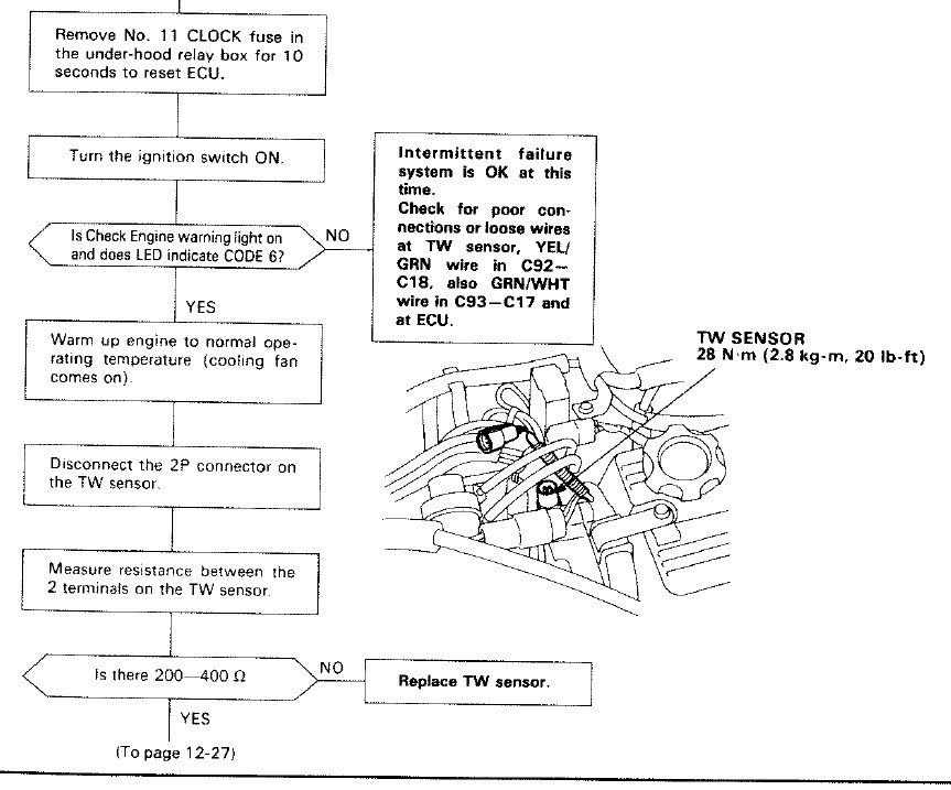

my car is doing the same my light blinked 6 times with a 2 second pause it’s a 1986 accord LXI what’s the codes
Old Dec 25, 2023 | 10:57 AM
Coolant temp is code 6, I don't own a 3rd gen anymore but memory tells me it is two pins, located around the dist area. Not the one for the temp gauge, the one for the computer
Old Dec 25, 2023 | 11:01 AM
SamKCMO's Avatar
Joined: Dec 2023
thanks I looked at one of the connections and it has corrosion
