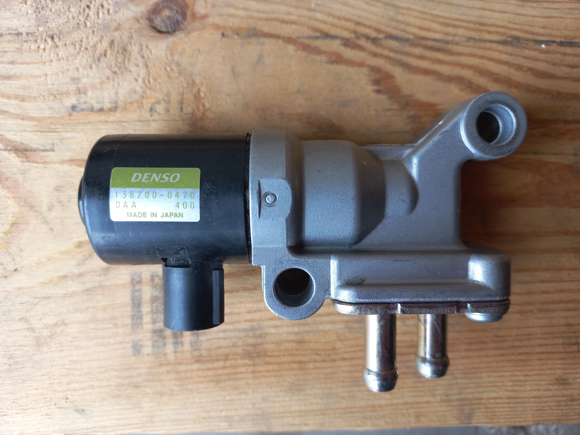

However, after a lot of searching, I got to RockAuto.
And found some parts there:
https://www.rockauto.com/?carcode=1167410&parttype=6072
For the EX model, there was one part from Standard Motor Products, $221.
And another from WVE, Wells Vehicle Electronics, $145.
https://www.rockauto.com/en/moreinfo...167410&pt=6072
I ordered the Wells product.
Turned out that it actually has the OEM logo (Denso) on the part
Nice!
See the images.
Wells Vehicle Products, Denso, 36450-P0A-A01
The part number at WVE is: 2H1125
Wells Vehicle Electronics, 2H1125, Box
Old Aug 9, 2023 | 12:50 AM
TechQuestions's Avatar
Joined: Jul 2023
Posts: 9
Forgot to mention, before ordering the second part, I
took the car to a shop, to get checked for vacuum leaks.
They found none, but isolated the problem to the
Slow Idle Air Control Valve
Thus, my searching for another part.
After I installed this OEM part, the engine calmed down completely.
Between 730 and 875 RPM,
Yeah!
