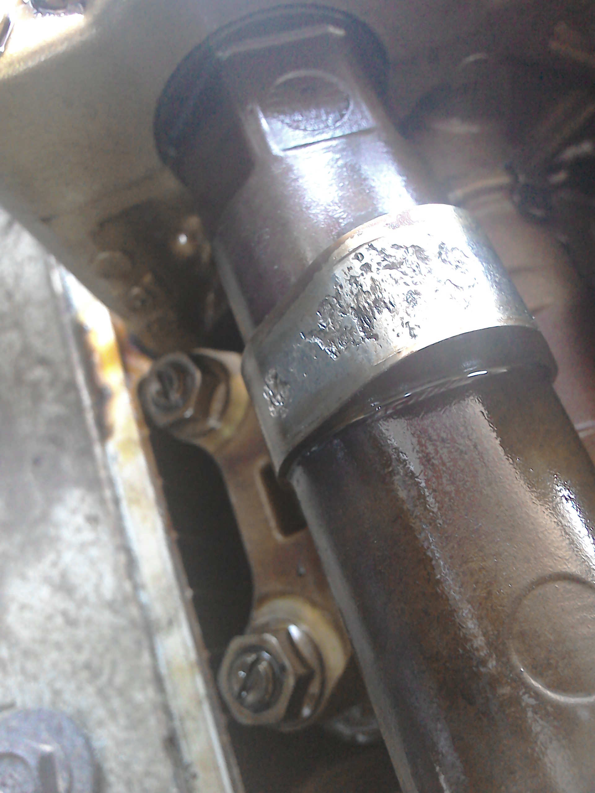

I just decided to carry out a service on my new 2003 accord tourer and also check valve clearances so I started doing the valves first while engine was cold I took the cam cover of and found one cam lobe has started breaking up, the hardened surface is peeling off
At the moment I am having a bit of a battle with the warranty company as to what they consider to be (worn out or breaking down) I am saying the cam is failing. Anyway if the worst comes to it I may have to carry out the work myself. So any info would be greatly appreciated. Has anybody come across this problem on Honda cams before?

Spalling of the surface sure seems like it wouldn't be "wear". To me, "wear" would have to be more like a uniform polishing appearance.
Has the warranty company actually looked at the camshaft yet? Got a photo?

I am going to attempt to show a PIC of my poor camshaft. Worn or what???

Beyond worn; more like toast. Time for a new cam and cam followers.
Old Aug 24, 2015 | 11:21 AM
Lack of oil lube is most likely reason for wear. Suggest carefully checking that oil is being delivered through galleries to top of the cylinder head. You may need to start engine w/ valve cover removed.
