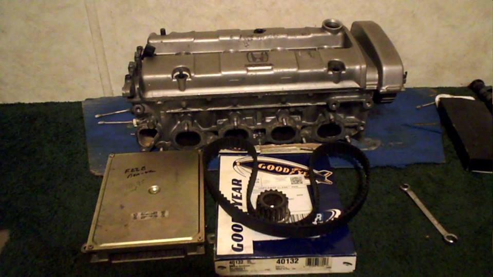

Here is pretty much everything I need for the swap in one pic minus the head gasket.
List of parts and prices I payed:
- P39 ECU ~ $49.00
- F22B Dohc Cylinder head Obd II ~ $150 (came with idle air, injectors, and intake manifold which I am selling on eBay.)
- Goodyear Timing belt for 1988 Dodge Caravan ~ $6.95
- H23 timing gear ~ $20.00
- Head Gasket Kit for F22A ~ $40.00

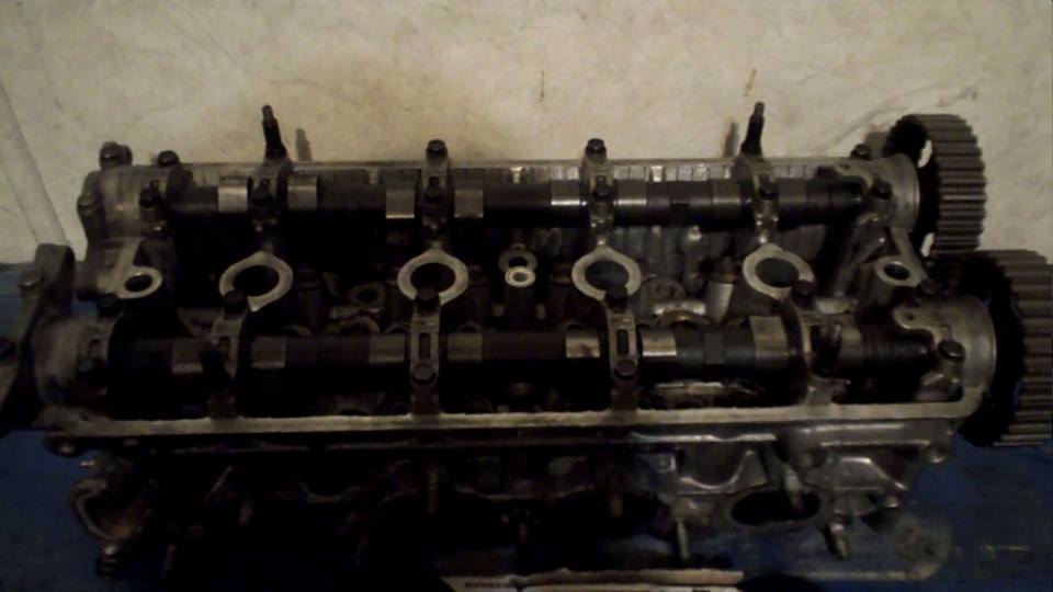

The cam caps and rocker arms I got from an H23 head with low miles. It seems to work perfectly with the H23 cams, smooth as oil.

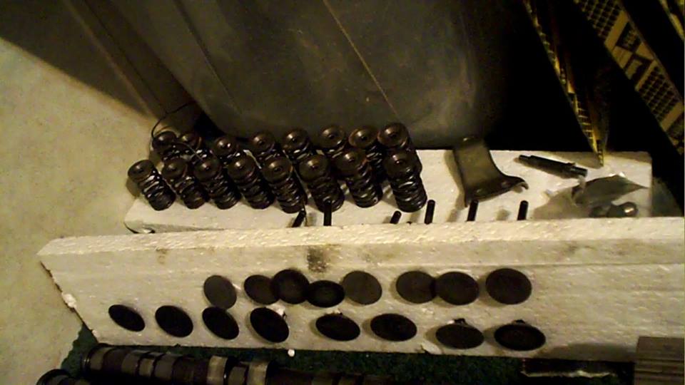

Removed valves and springs:

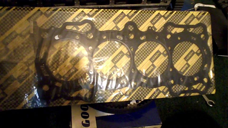

F22A head gasket from kit I got online:
