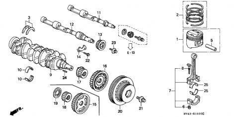

On the end of the crankshaft (inside the plastic timing cover but outside of the oil pump) you want to use the stack of sprockets from your 1997 engine. In the picture, your 1997 engine should have #16 & 17. The older OBD-1 engine should have #15, 18, & 19.
