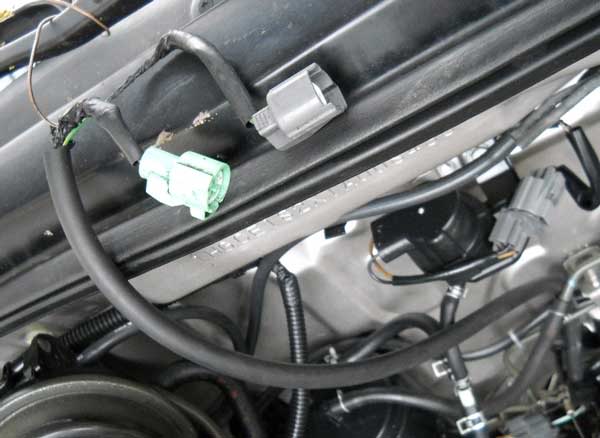

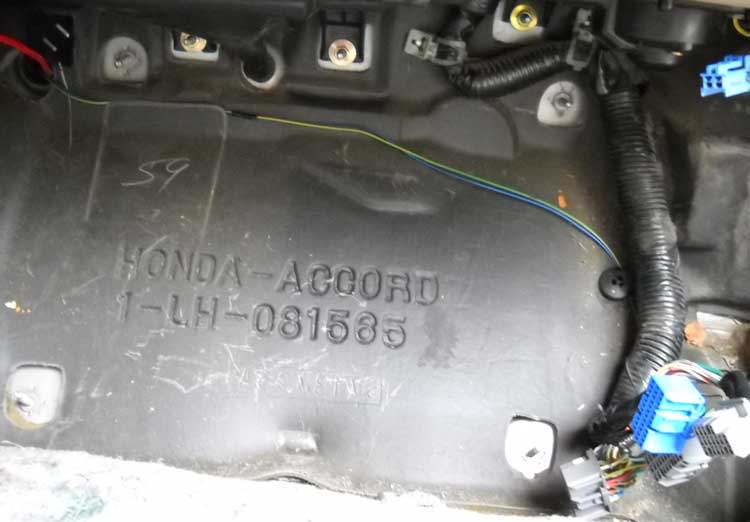

ECU: Not positive since it's OBD1, but I think you do need a manual trans ECU. A quick web search showed 37820-P0A-A01 as the part number. Wiring VTEC isn't all that difficult. Cut the harness out of the ECU donor car if they'll let you & be sure to include the solenoid (VTS) & pressure switch (VTP) plugs & pinned ECU plugs when you do. Try to keep the harness in one piece without cutting the VTEC wires. Then just unwrap the tape, remove the plastic wire loom, and extract the intact VTEC wiring harnesses. I just ran both wires separately through the firewall grommet that holds my amp power wire. I think the wiring is D6 (VTP) and A4 (VTS). You should be able to find an OBD1 ECU pinout online to help you identify the plugs & pin locations.
A good how-to on OBD1 ECU plug pin removal:
phearable(dot)net/tech/wiring/obd1pinremoval(dot)jpg
Attached Thumbnails F23 swap in Gen 5-vtec_plugs.jpg   F23 swap in Gen 5-vtec_wire_ecu.jpg
