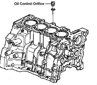

As stated you need the timing belt from a 94-97 F22B1 VTEC
The oil control orifice is a brass plug located in the center of the engine block surface. You need to remove it in order for enough oil pressure to enter the cylinder head from the block. Without removing the orifice you will not have the proper oil pressure for the VTEC assembly and it will not engage.

Attached Thumbnails honda accord f22 mini me swap-oil-control-oriface.jpg   honda accord f22 mini me swap-engine-block-surface.jpg
