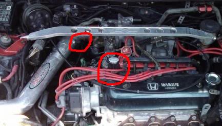

umm BTW you need to take that filter off your VC and replace the hose back to your intake. I circled in red what I’m talking about. That filter will actually clog up and block the extra gas from being vented. Also your crank case need to be under vacuum that’s why there is a hose that goes from your valve cover to your intake to keep it under vacuum.

I'd like to have the power of a standard put I already have auto and couldn't even imagin what it would take to swap. Think I'd rather the auto being that I'm always in traffic. Thanks on the input on motos. I wanna go with a reputable comp. Oh and thanks alot on the letting me know about that filter. It was on there when I got car. The guy who did all the work is supposed to be master honda mech. I'm starting to doubt that.
