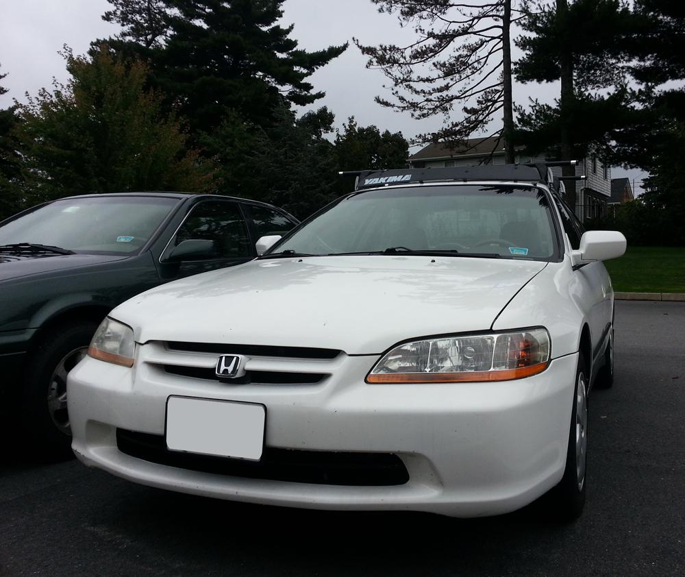

Hey guys, I've been noticing some small issues with my 2000 Accord and thought that this would be a great place to start.
Here's my car:
It's got 184k miles and it has been problem free since my father bought it new. Very recently (the past ~500 miles) I have noticed the clutch goes soft after a moderate amount of city driving. At one point the clutch stuck to the floor and I had to pull it up with my foot before being able to drive away from a stoplight. From what I've read this is a failing clutch master cylinder.
