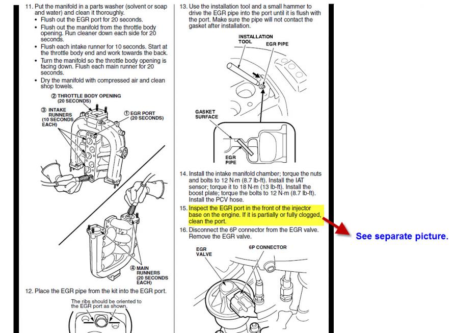

This link is for the Honda TSB:
http://www.tegger.com/hondafaq/tsb/accord/A99-085.pdf
I also attached a picture of another EGR port on the engine that people sometimes miss cleaning, since it is not illustrated on the TSB. This is the port referred to in step #15 of the TSB.
Essentially, the EGR port cleaning should be done on the intake manifold and the engine.
Attached Thumbnails 01 accord v6 EX sedan EGR problem.-step-15.jpg   01 accord v6 EX sedan EGR problem.-engine-port.jpg
