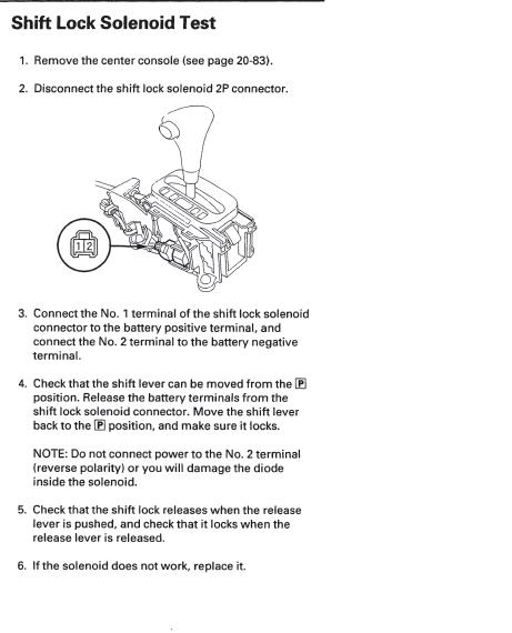

Are you sure the brake lights are working?
Here is a test of the solenoid
Attached Thumbnails 01 LX shifter selonoid not working-6th-gen-shift-lock.jpg

Thanks for asking that question. I just checked, and indeed all 3 brake lights are NOT working.
Is the brake light switch the most likely place to start? The situation was intermitent for nearly a year before the solenoid stopped working altogether

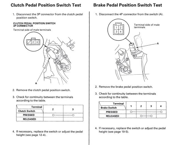

If your brake lights aren't working and you can't shift out of Park, then it is most likely a problem with the brake light switch (aka brake pedal position switch).
The switch itself also is not that expensive. Believe or not, on some models, the dealer sell the brake light switch for less than aftermarket.
Attached Thumbnails 01 LX shifter selonoid not working-6th-gen-accord-brake-pedal-position-switch.jpg

Only thing I can add to what redbull posted is to also check the fuse for the brake lights.....let us know what you find.
Attached Thumbnails 01 LX shifter selonoid not working-6th-gen-brake-switch-test2.jpg

fuse was fine. checked that first. Bought a $35 brake light switch with lifetime waranty from local auto store...works like a champ. Back in business.
Thank you both for the help.
