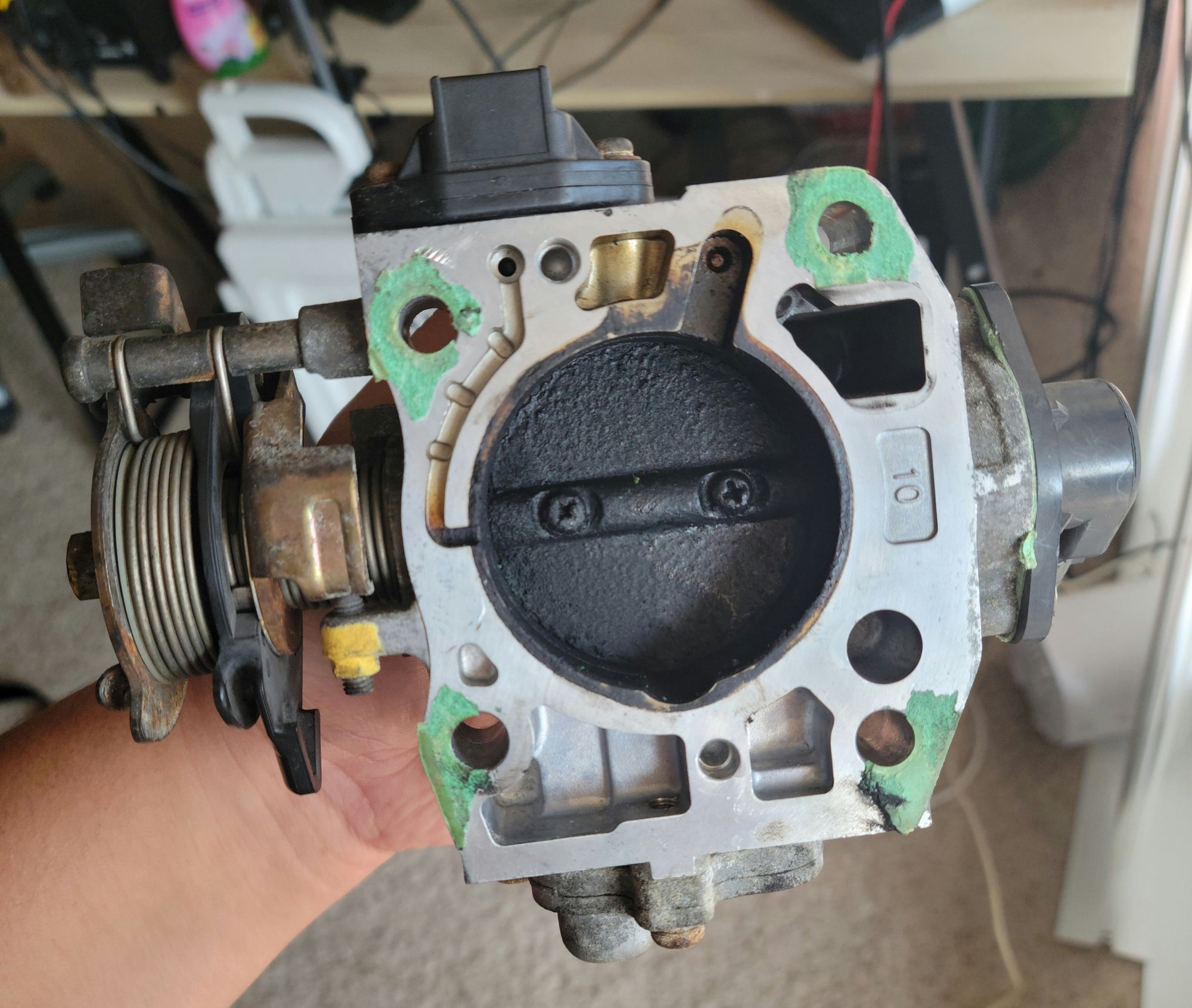

When jiggling the key, the car stays on so I ruled that out. what I ended up doing was taking off the throttle body and found that the backside of the plate was completely gunked up (pic below). Cleaned it up with CRC throttle body cleaner and replaced the air filter as well.
I also found there was a lot of buildup around the bottom portion of the distributor cap and took the cap off and found the gasket was broken so I replaced that as well.
After doing everything, the car runs so much smoother now. Took it for a 15-20 min drive, revved the engine up while parked (it even goes past 4 on the rpm gauge now without hesitation) and the car stayed on so I believe it was the throttle body that needed to be deep cleaned.
