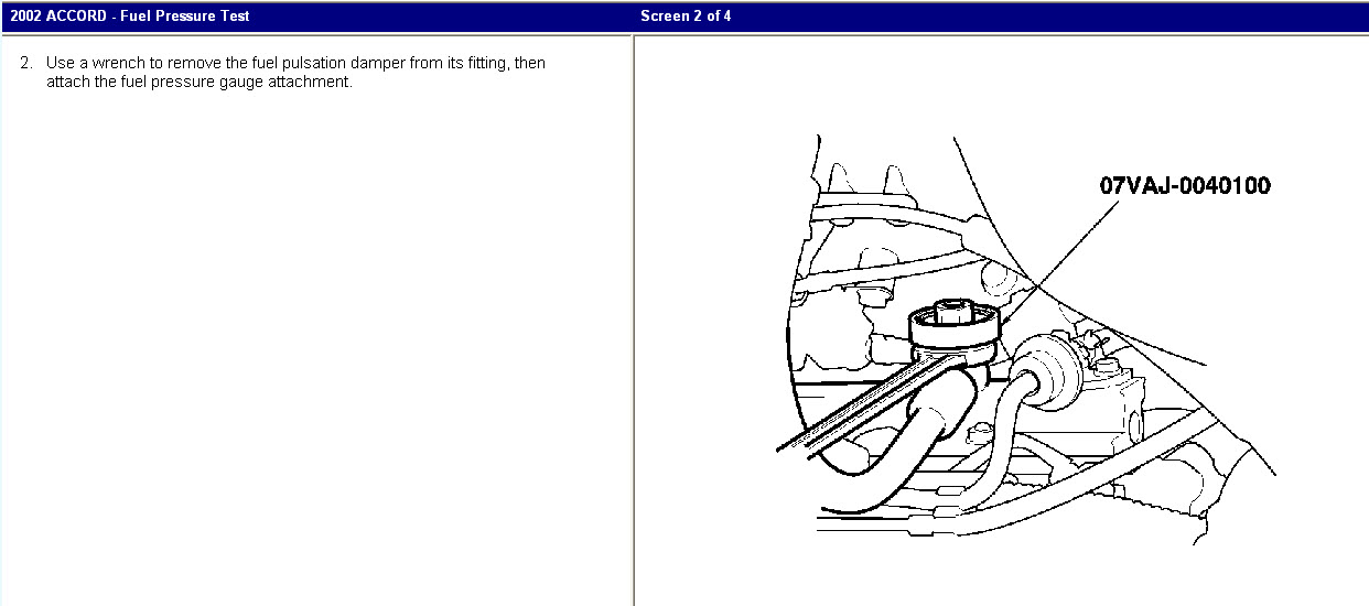

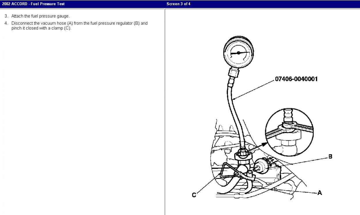

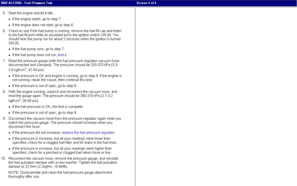

Also how do I check my fuel pressure!!! Anyone?
Attached are the procedures for your car.
Attached Thumbnails 02' Accord F23a4 Stalls when Hot-2002-accord-l4-fuel-pressure-test-1.jpg   02' Accord F23a4 Stalls when Hot-2002-accord-l4-fuel-pressure-test-2.jpg   02' Accord F23a4 Stalls when Hot-2002-accord-l4-fuel-pressure-test-3.jpg
