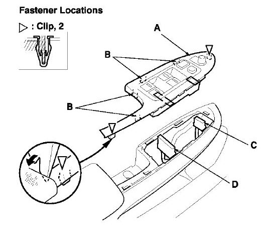

It sounds like the power window master switch. There's a multiplex control unit integrated as part of the switch. First remove the switch and check for bent terminals and that the connector is tight (e.g., door panel was removed before).
Otherwise, it may be the master switch.
This video is removal instructions for the sedan; but, should be similar to your coupe.
youtube.com/watch?v=bEzq4HrRYuI
Attached Thumbnails '03 Accord coupe driver window doesn't always work-power-window-master-switch.jpg
