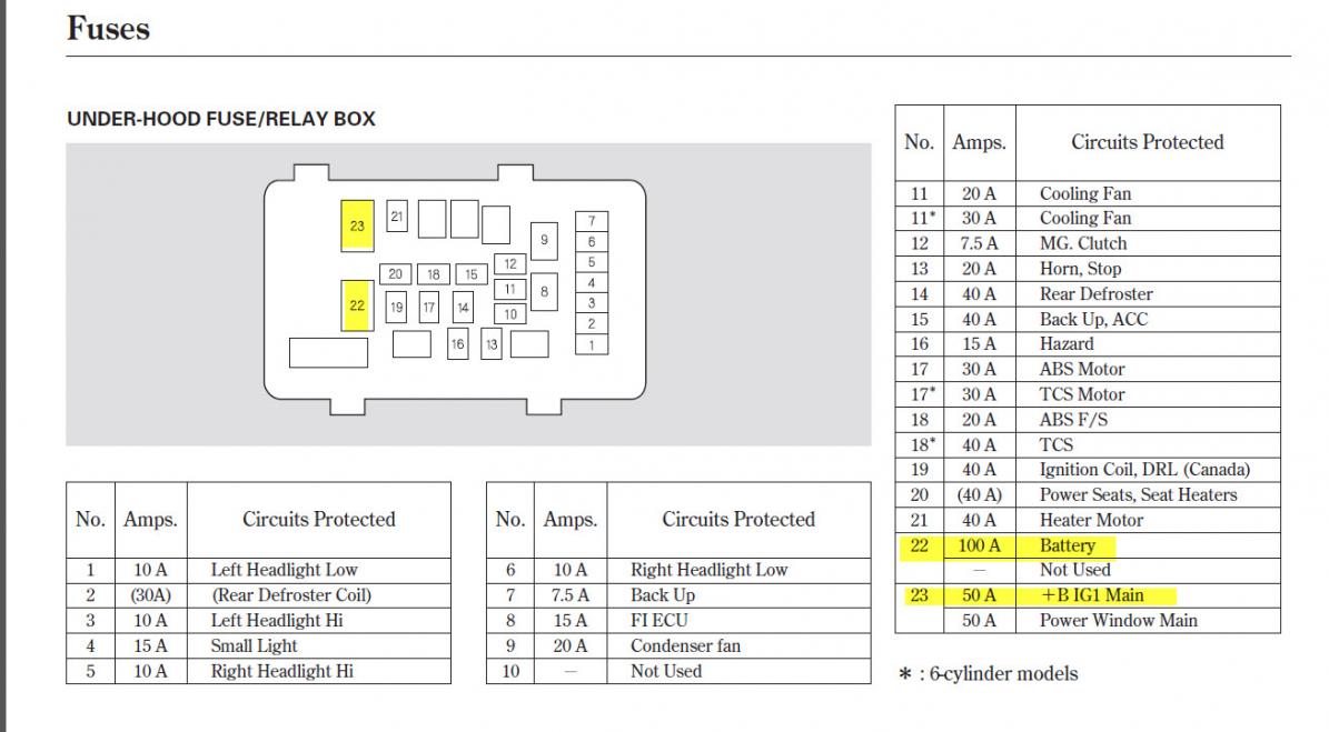

You stated you checked the battery fuse; but, also check the main fuse.
Attached Thumbnails 03 Accord - No Electric Power-fuses1.jpg   03 Accord - No Electric Power-fuses.jpg

Redbull-1 helped me with this a few months back( Thanks again). It was the main fuse for me. AAA guy crossed the cables on a jump. Easy fix, and I'm not a car fix it guy so to speak.

Yep, checked it again....it was the main fuse. I missed it the first time...just a tiny hairline break. Needed to put on my 3X reading glasses to see it. Thanks for the help!
