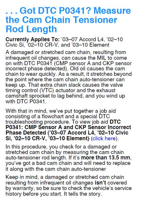

Did you regularly check the oil level? Although regular oil changes are necessary, the oil level should be checked regularly too. Some cars burn oil faster than others. It also depends on driving conditions, driving style, etc. It probably was low on oil.
The attached image has some info. regarding infrequent oil changes; however, yours could have been caused by low oil level and low oil pressure.
I am not sure what to tell you, not knowing the condition of the engine.
