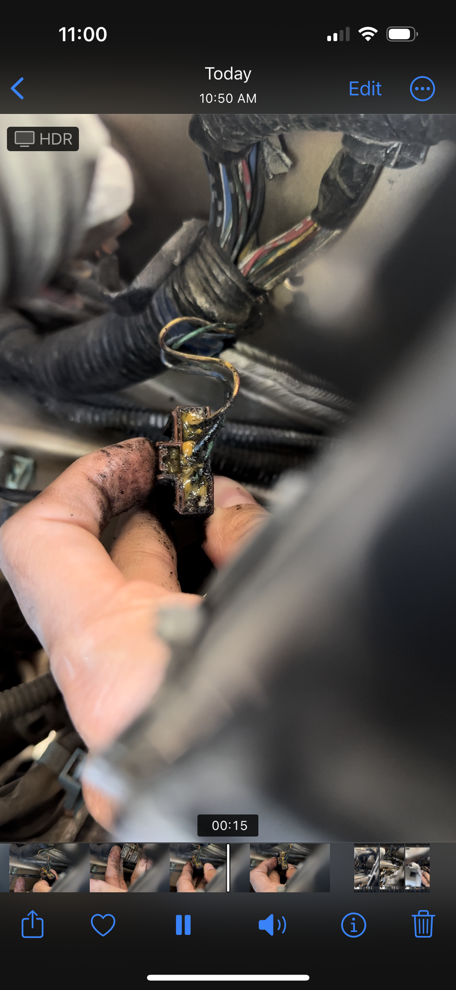

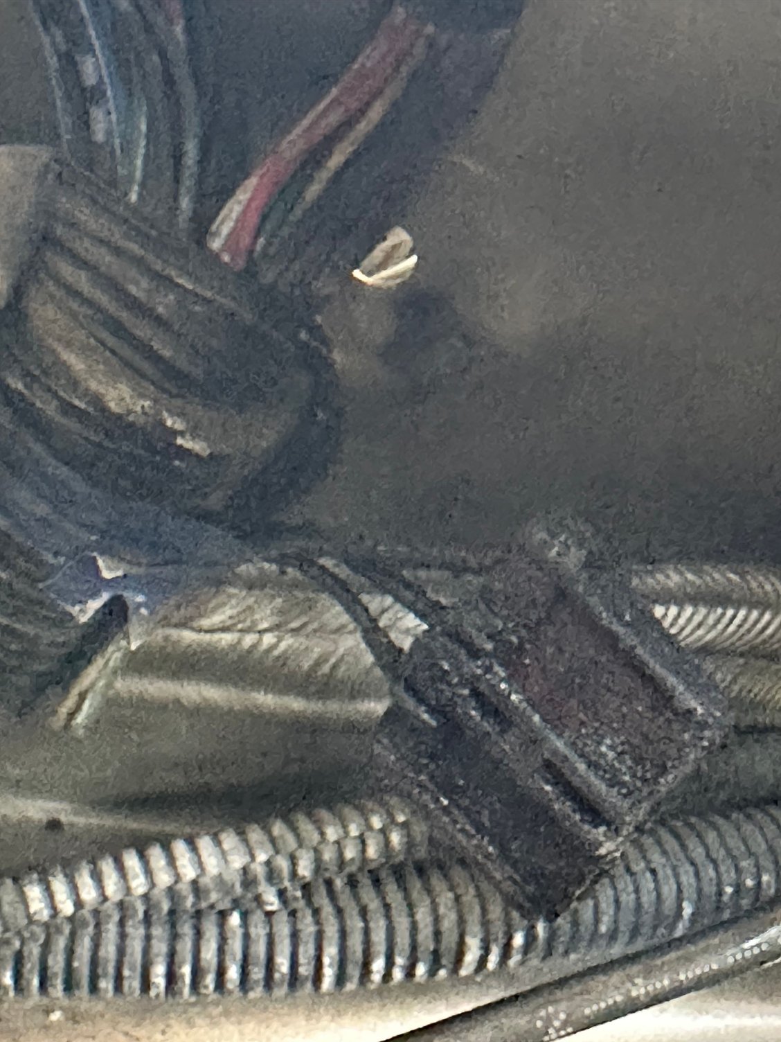

so I started looking for the obvious issues, transmission fluid is good, level is correct, no metal shavings or cloudy, looking under the fuse box under the hood I noticed a charred fuse maybe? This might be the problem. Can anyone identify what this part is called and where can I find a replacement
This was placed against the wall, you can see the black spot
When I pressed on it to detect it some gooye stuff like grease came out

My 05 TSX has a similar unplugged electrical connector near the fuse box. I believe is it for a component that does not come on US Accords. In general, OEM honda wiring doesn't have in-line fuses, so don't put a fuse in there. At maximum, clean up the grease with something like WD-40 and put some silicone grease in there to prevent corrosion. This isn't likely your problem with the PCM codes.

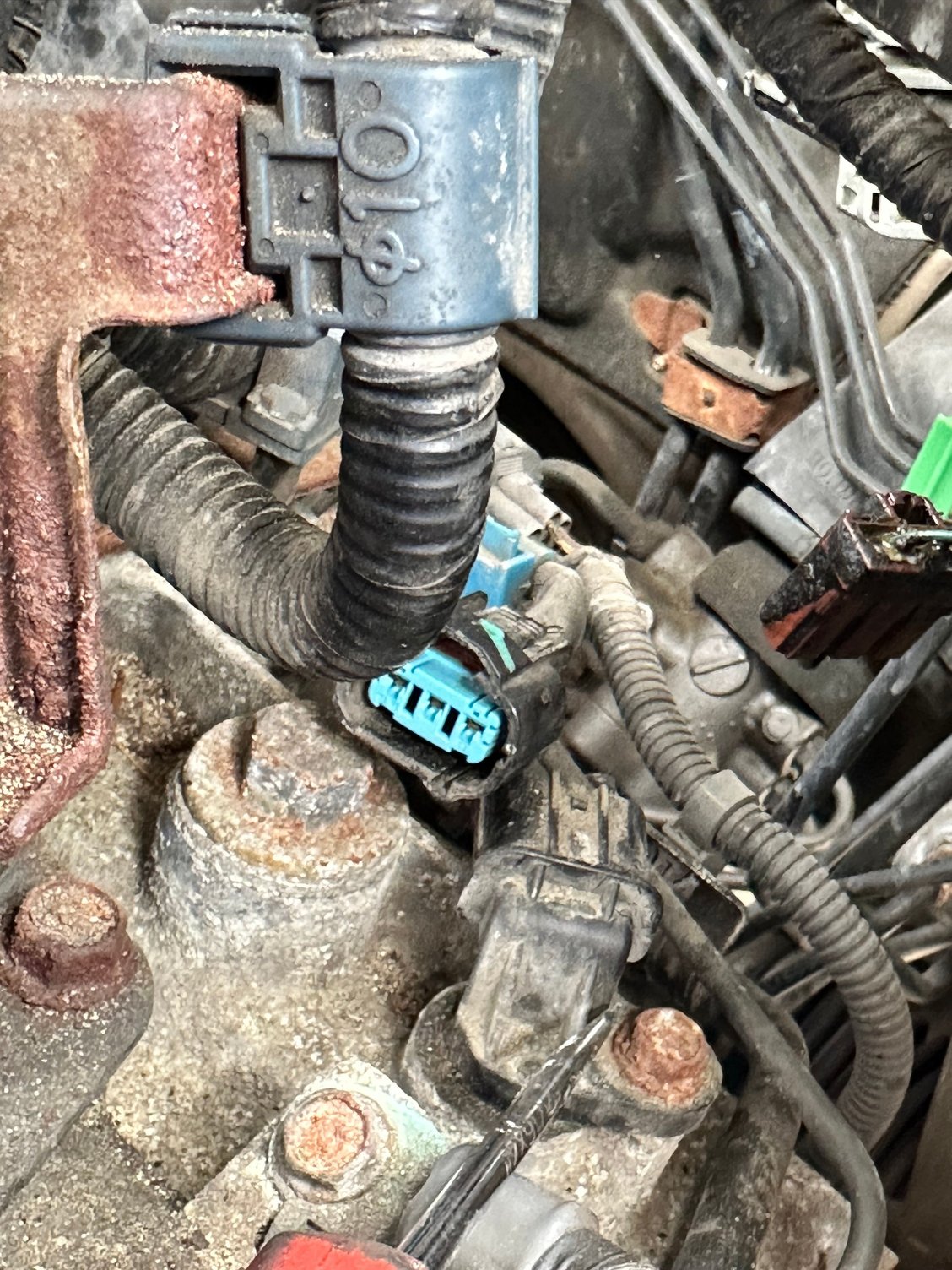

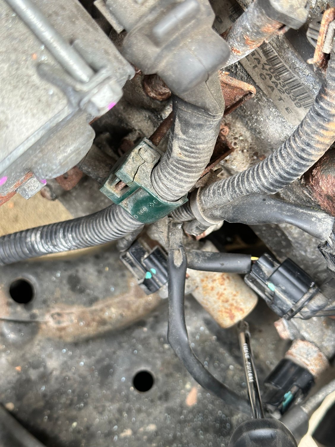

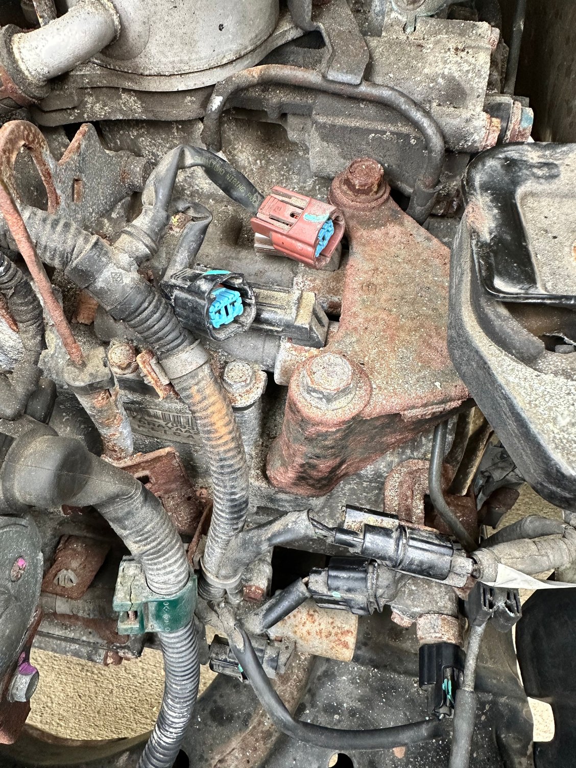

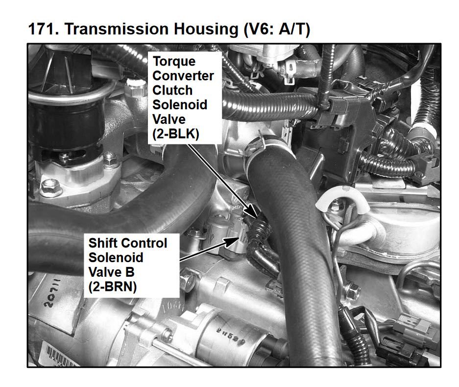

I attached a pic of the locations of the solenoids. I'd start by unplugging the sensors electrical connectors, inspecting the pins, then clean the connectors to ensure you have good contact. The solenoids typically have screens to catch any debris that can clog them and might be worth a shot to remove the component and clean any debris blocking fluid flow.

Thanks for the diagram, last image next to the screwdriver is the solenoid C right.
the 2 connectors I disconnected in red and black are the solenoid B and A
can’t forgive out where’s the torque convertor clutch solenoid

The brown 3P connector is known as Option Connector - C310.
Here is a photo of the option connector; in addition to some of the A/T control connectors.
