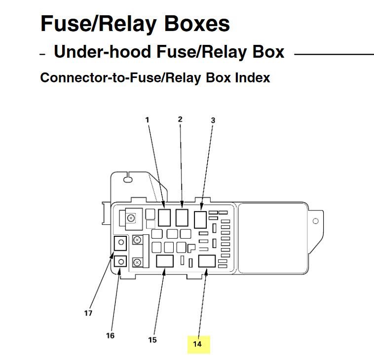

Hello, my driver side radiator fan I've been running for 2 hours with the car off!
Can can anybody tell me how to get this to shut off without unplugging my battery..(battery scares me)
​​​​​​ I'm fairly new to working in my own engine so many details and pictures are welcome!
Old Jul 1, 2021 | 11:07 PM
Posts: 7,101
Is this a 4 or 6 cylinder vehicle?
It looks like the driver's side fan is the radiator fan.
The radiator fan relay contacts may be shorted. You can pull that out to stop the radiator fan.
Its a 4 cylinder, thanks I will give that a try

It is possible the cause of your issue is a faulty relay.
