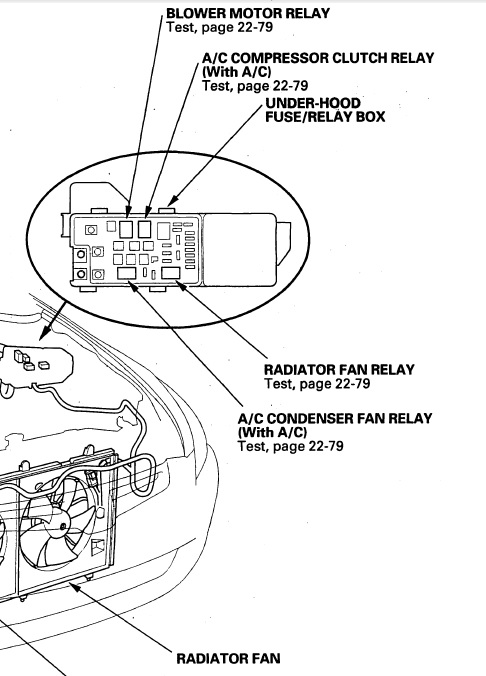

The driver's side fan is the radiator fan. Passenger side is the condenser fan. Both fans turn on to cool the radiator and condenser to help cool when the engine is running.
A quick way to tell is the a/c condenser fan is the one in front of (or closest to) the a/c compressor.
The 90-97 accords had a feature where one fan would turn on when the engine is turned off. I think the 98+ accords do not have this feature. Let me verify.
This could be a relay problem. Switch the condenser and radiator relay (see attached pic for location). Let us know if this problem fan switches.
Also, do you have a volt meter?

First off I would check the temperature switch sounds like it is not functioning properly,not sure on your 04, but 90 to 98 i believe use a fan timer module that turns the fan on when the engine is hot and ign off. they use a 2 thermal switch system that are set for a low and high. I believe yours only has the one temp sender usually located at the neck on the engine where the radiator hose connects. Just unplug and check the switch itelf for continuity using an ohmeter or a self powered test light if you have continuity or the light comes on with the engine cold the switch is toast. about $10-$20 for a new one
