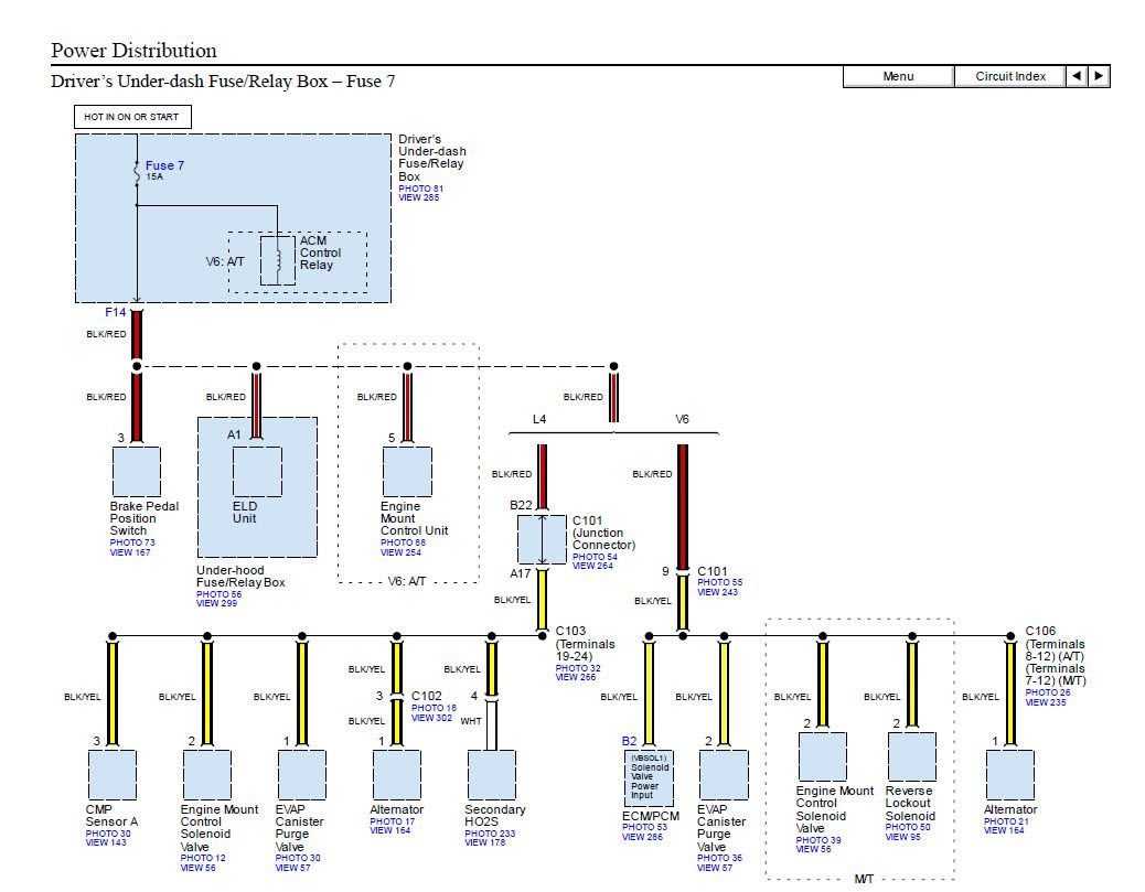

Hoping someone can point me in the right direction or has a wiring diagram for the alternator. I found a schematic but it leaves a lot to be desired.

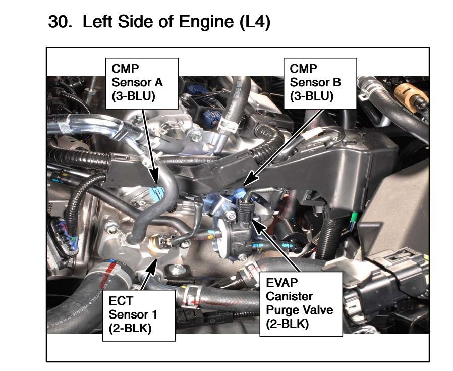

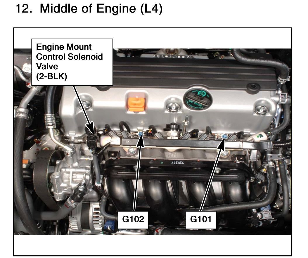

Driver's under-dash Fuse No. 7 protects the following on a 4 cylinder:
Alternator, Brake Pedal Position Switch, CMP Sensor A (L4), ELD Unit, Engine Mount Control Solenoid Valve (L4), EVAP Canister Purge Valve, Secondary HO2S (L4)
Looks for damaged wiring, etc. Possible rodent chew, etc.
