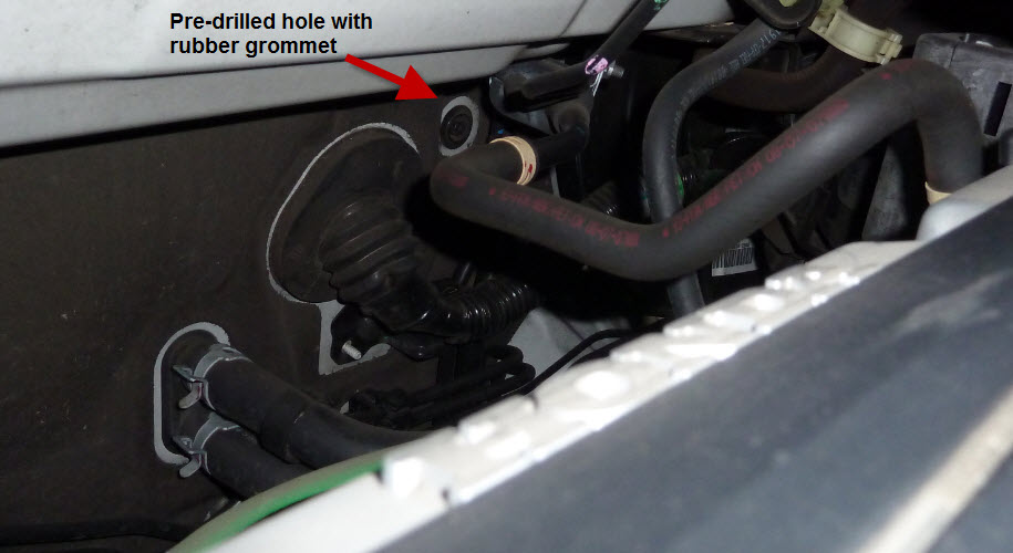

1. The fuse slots that are hot in START or ON are located in the driver's side under-dash fuse box, as stated in my first post. Get a Littelfuse Add-A-Fuse MINI and use one of the unused slots in the interior fuse box. No. 1 and 2 slots are unused and readily accessible in the lower right-hand corner of the fuse box when you look up under the dash. You will have to run one wire for power ( +) into the interior doing it this way.
http://www.littelfuse.com/~/media/Fi...FHM02FHA02.pdf
Just because you may want easier access in the under-hood fuse box, does not mean it is there.
2. If you want to run the power wire to the interior, there is a pre-drilled hole with rubber grommet at the firewall. You probably can make a cut in the grommet to run the wire through.
Attached Thumbnails 08 Accord ex led drl-8980d1354549875-new-here-i-wanna-put-some-leds-my-front-grill-09-accord-firewall-hole.jpg
