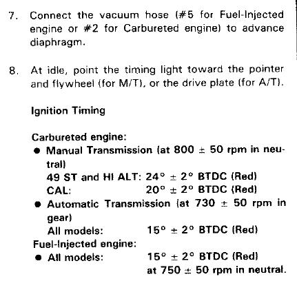

To get a mark of 22 to 26 (you'd have a carb'd -dx confirms that - engine AND be a manual trans) BUT #2 vac hose whould HAVE to be connected to get this reading.
Pull both vac line from the dist advance, plug them both. Do you get ~4 btc?
I don't want to sound like an "A" hole but I would be willing to bet I've spent more time "playing" with a 3rd gen Accord (carb or FI) than you or the smog tech put together.

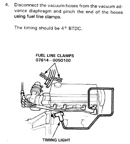

I did leave out that the engine should be at normal OP temp when doing this.
And I have to assume the all of the PVS are in proper order and that...no strange "high idle" when re-starting a warm engine or anything else.

You dont sound like a a hole lol. Thats why im on here, this is my first honda. And yes, with the vac lines off and pluged, i get somewhere around 4btdc. Tdc is just in site. Never and rough idle or anything at any time. This motor runs excelent considering its age. And yes, carb ohc i4 w/5 speed manual. Im just out of ideas, i have gone through all the vacume lines looking for leaks or vacume where there should not be or lac of vacume when there should be. Figured the egr was bad that way. Replaced some lines. Then hit the motor and electrical.
