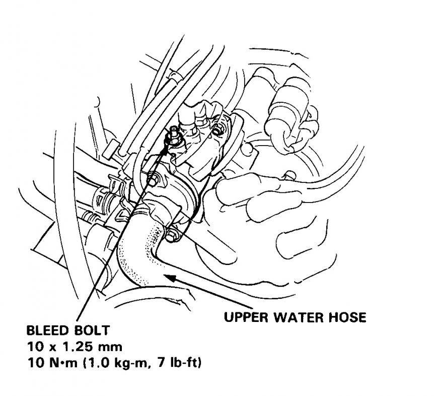

There is a bleed valve on top of the thermostat housing. When the engine is cool, open radiator cap, loosen bleed bolt, allow air to spit out of bleed valve. Once a steady stream of coolant comes out, close bleed bolt, top off radiator.
Attached Thumbnails 1987 honda accord hatchback 2 dr/ HELP-bleed-valve.jpg
