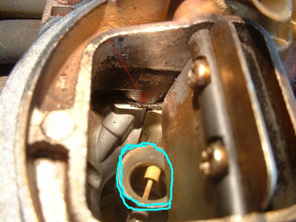

Sounds like the float needle is either stuck open or closed. Can you check the level in the float bowl? This is hard as if it is over filled or empty - it kind of looks the same.
If you remove the top and bottom part of the air cleaner. Give the top of the carb - drivers side gentle taps with the handle of a screw driver......see if this might free up the float or seat.
EDIT: You get get lucky and it just be the o-rings on the adjust screw.
If not, yea you might have to pull the top of the carb - can be done while on the car. And check the float and the float needle and seat.
Wow, two 3rd gen carb's in one night....I might be of some use after all.
Attached Thumbnails 1989 Accord Lx fuel and carb problems.-3rd-gen-float-level-adj.jpg   1989 Accord Lx fuel and carb problems.-3rd-gen-carb-throat-my-leak.jpg

That red arrow pointing to a leak, That is exactly what mine looks like, I thought a gasket might have ruptured there. As for the needle and seat is there anything from the top I can do to check it? Maybe move it up and down try to free something up?
