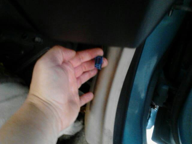

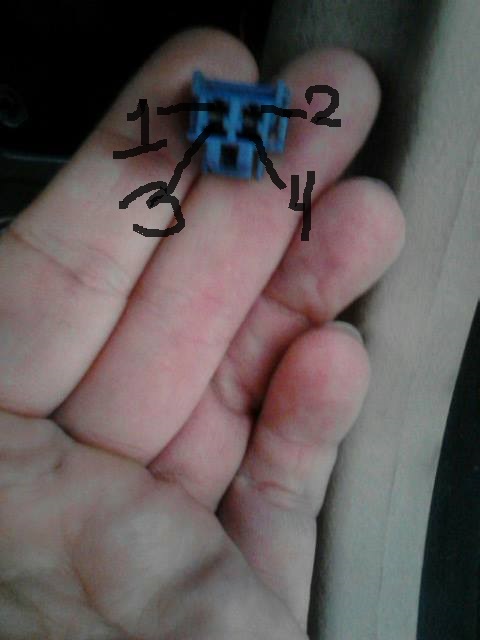

Ok i think i found the connector blue thing does it look like this? I pulled back carpet to look but found this under glove box under dash---also i dont know whether to put the paper clip from hole 1 to hole 2 or hole 3 to hole 4(see picture i attached). I tried to start it before i looked for the connector, and some guy walking buy said it sounds like your fuel pump. FORGOT TO LOOK FOR OIL INPLUG---ITS DARK NOW SO I WILL IN THE MORNING

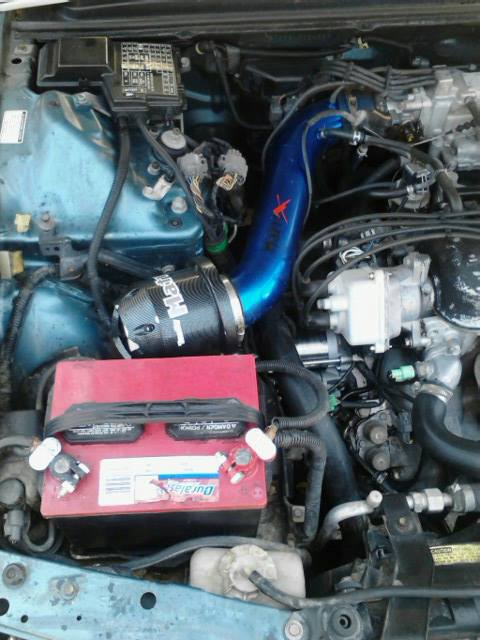

Default Pictures under the hood
Heres under the hood
Attached Thumbnails 1990 honda accord died while driving and i had to walk home-1.jpg   1990 honda accord died while driving and i had to walk home-3.jpg   1990 honda accord died while driving and i had to walk home-4.jpg   1990 honda accord died while driving and i had to walk home-5.jpg   1990 honda accord died while driving and i had to walk home-6.jpg

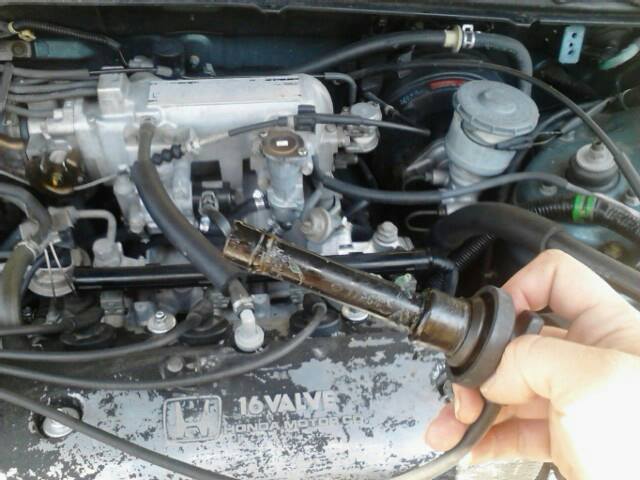

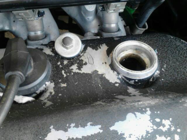

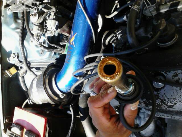

Default Pics of plugs
No oil in this thing--some greenish gooey stuff a littl bit
Attached Thumbnails 1990 honda accord died while driving and i had to walk home-993067_508949382507597_1166562407_n.jpg   1990 honda accord died while driving and i had to walk home-1006190_508949429174259_1927746595_n.jpg

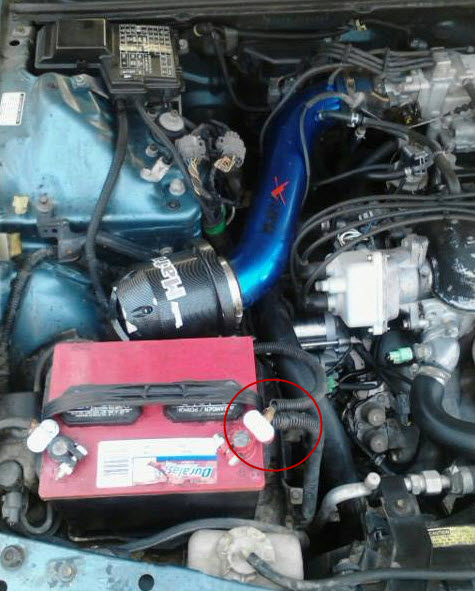

Look for the service check connector like the one shown in this thread:
https://www.hondaaccordforum.com/for...ad.php?t=49074
This may or may not have anything to do with your problem; but, the battery cable connector and cable seems a little iffy.
Attached Thumbnails 1990 honda accord died while driving and i had to walk home-battery-cable-connections.jpg

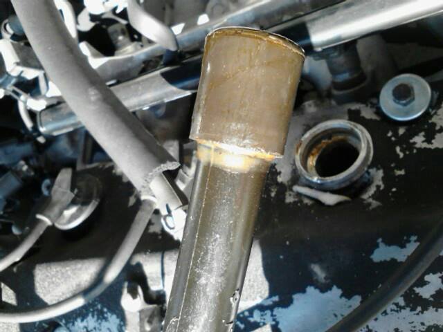

Default New info
I went to double take a look at the spark pluggies becuz before when i said no oil, i had only looked at one. I went and pulled all 4, 2 didnt have any but look how much the other 2 had- so this changes things huh? So do i still have to check the codes?
Attached Thumbnails 1990 honda accord died while driving and i had to walk home-1003279_508995689169633_398861610_n.jpg   1990 honda accord died while driving and i had to walk home-1005870_508995675836301_106191562_n.jpg
Old Jun 19, 2013 | 11:58 AM
  #18
Still check the codes. If you get misfire codes, then it might be explained by the oil. Some other codes might be additional things going on.
To fix the oil, it's a new valve-cover gasket set. Search for "oil in spark plugs" or something like that. Should be several threads with good explanations.

Hi Kristen, as the other members stated check the codes. The wire is located on the passenger side below the glove compartment on the side in front of the door. Also if oil is in the spark plug well. the valve cover need to be removed,and there are 4 seals that need to be replaced
Here is a link for the replacement of those seals;
after all this is done, your car should start up with no problem
Hope this helps!!!

  #20
Kristen Kallos Sager's Avatar
Joined: Jun 2013
Posts: 17
From: SAN BERNARDINO,CA
OK THANK YOU BUT IM GONNA PUT A PICTURE IN THIS MESSAGE- IS THIS THE CONNECTOR IM LOOKING FOR AND DOES THE PAPER CLIP GO FROM HOLE ONE TO HOLE TWO OR HOLE 3 TO HOLE 4? (REFER TO PICTURE)
Attached Thumbnails 1990 honda accord died while driving and i had to walk home-935923_508593149209887_1500258852_n.jpg   1990 honda accord died while driving and i had to walk home-7896_508593122543223_61839425_n.jpg
