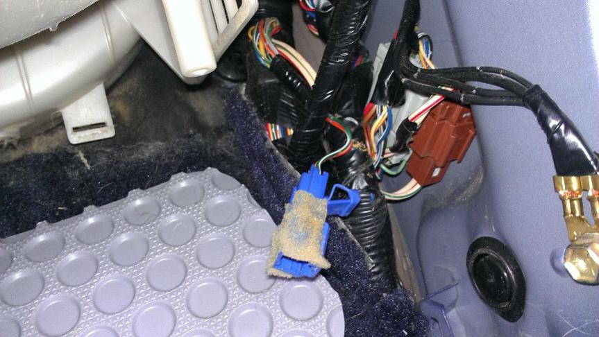

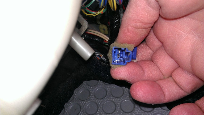

I have spent some time looking at threads / info. about checking the CEL codes for my car. I have seen some that said the '90 doesn't have the blue diagnotic connector plug that can be jumped with the paperclip...and others who say it does.
Can anyone confirm which is correct?
I looked and found a blue plug (the only one I can see) on the passenger side side panel...but it doesn't look like I can jump this plug with the connection...I attached some pictures to give you a look.
Is this not the diagnostic plug? Is something missing from it?
Thanks for your help.
AJ
Attached Thumbnails 1990 Honda Accord LX - CEL Codes-imag0029-2.jpg   1990 Honda Accord LX - CEL Codes-imag0028-2.jpg
Old Feb 13, 2012 | 10:32 AM
That is the service check connector (scs)/diagnostic plug. You may just have to disconnect/unplug the outer part of the connector first to use a paper clip.
Old Feb 13, 2012 | 01:07 PM
HALX9091's Avatar
Joined: Feb 2012
Posts: 4
Thanks...but I tried and couldn't figure out how to take that plug apart. I may just be missing something...i will try again...but in the meantime if anyone knows how to get ot apart...advice would be appreciated.
Old Feb 13, 2012 | 01:55 PM
Can't you just stick the paperclip in there as is? The photo looks like you can see the metal pins. All you need is ANYTHING to make electrical contact between the 2 pins.
