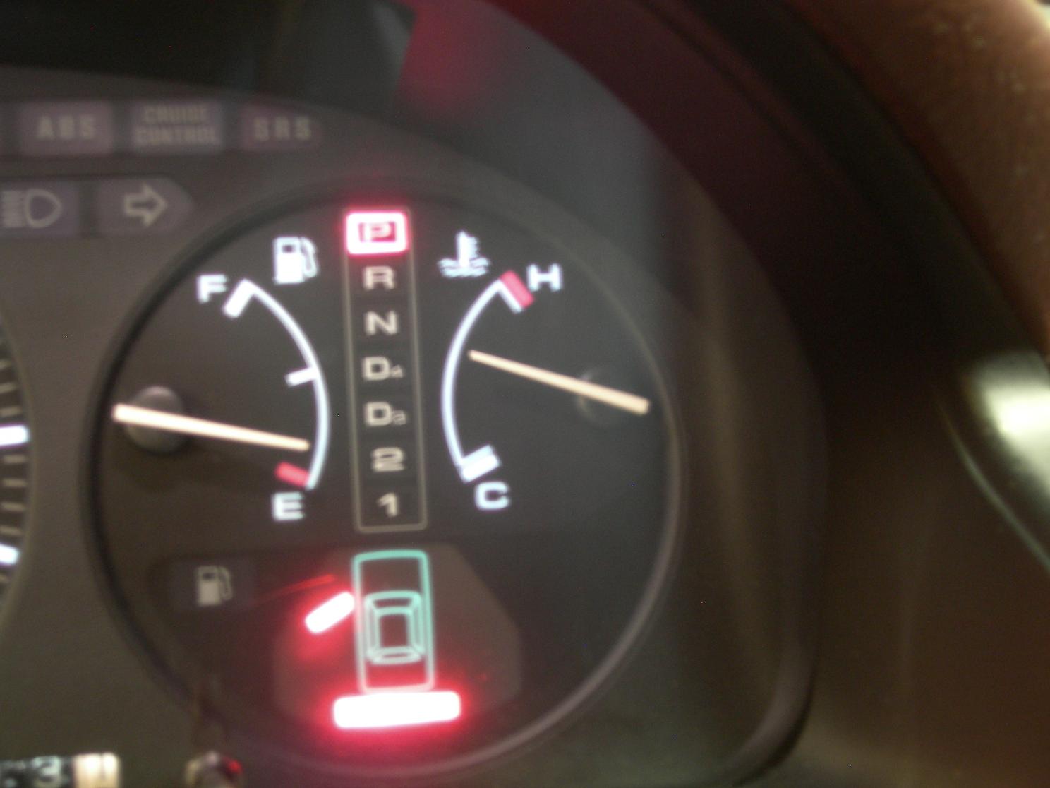

Thank you PAhonda. I actually have one of those w/a lazer pointer.
The first image shows where the temp guage is when the fans turn on and the second image shows where the temp guage is when the fans turn off.
Attached Thumbnails 1992 accord Overheating-cooling fans wont turn on-fans-turn-here.jpg   1992 accord Overheating-cooling fans wont turn on-fans-turn-off-here.jpg

If you have an IR thermometer, measure the temperature of the coolant when the needle on the gauge starts rising. Verify the actual temperature when the fans kick on.
